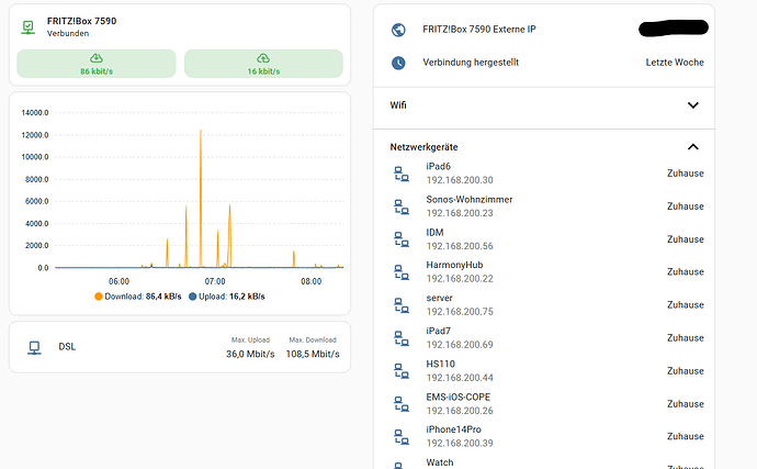

I am unable to create a working card code that shows all devices with IPs.

Thank you so much! :heart:
Would you mind sharing also some ideas how to sort by IP? I tried this but it does not sort by IP:

Ah, good to know! :+1: How did you find out? :wink: I should have observed this myself, of course. :face_with_hand_over_mouth:
And I need to add ip: true:
