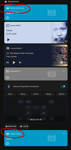

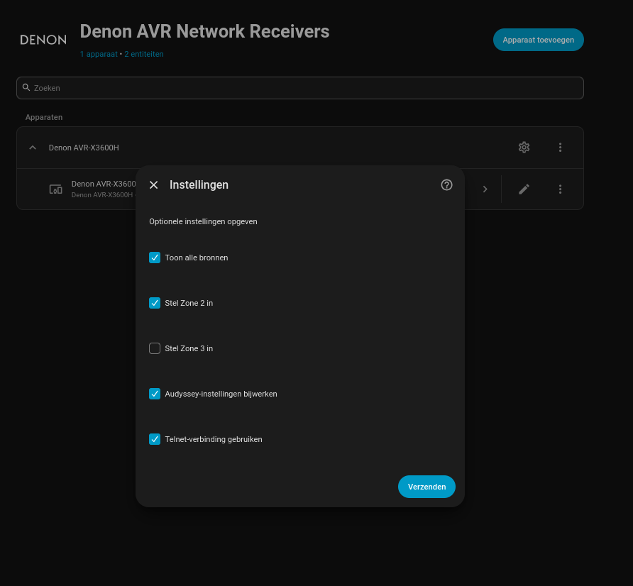

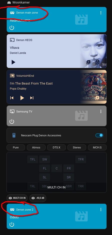

go to the integration and enable zone 2.
Works fine here with the same receiver...
That is ok when you play from HA...but how do you play from Music Assistant to that device
