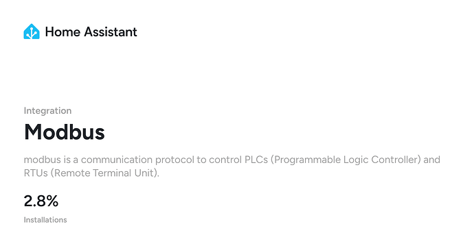

maybe the keys are wrong, see below. Does sensor needs to be sensors, switch needs to be switches ?
Also, doesn’t look there are number or select options

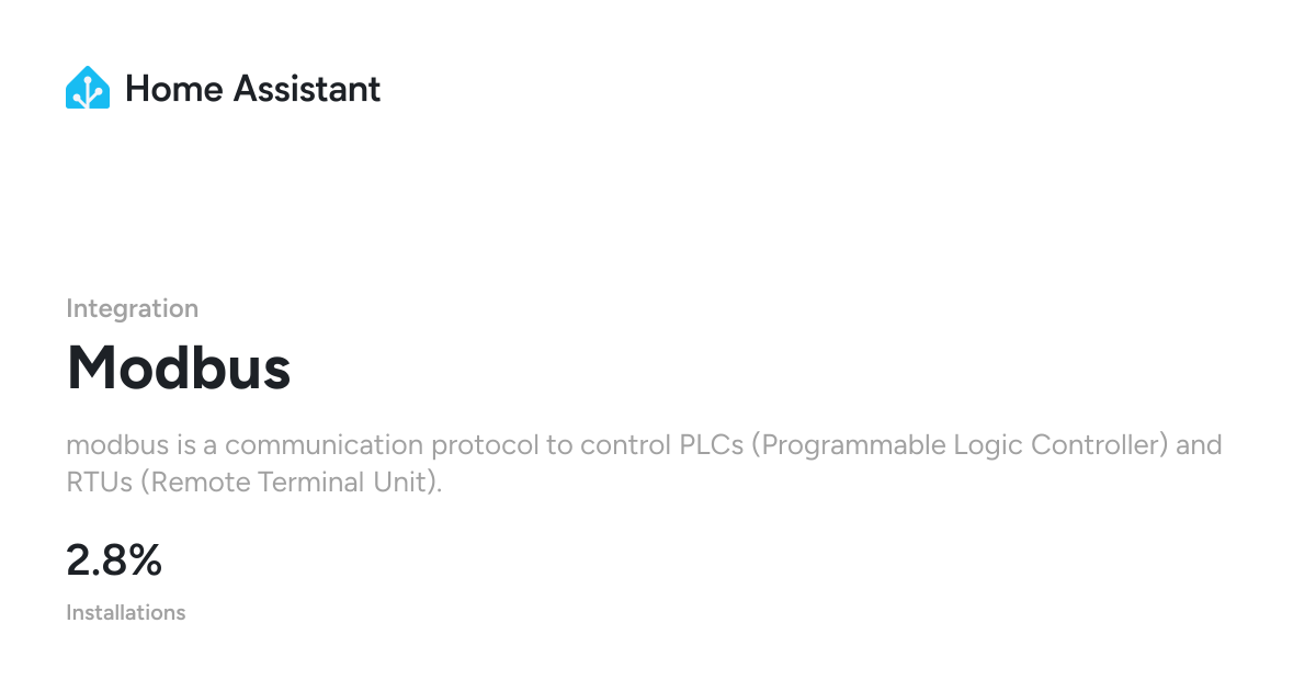

Hello your yaml looks not correct.
Try as per instruction:
modbus:
  - name: "carel"
    type: tcp
    host: 192.168.1.151
    port: 502
    delay: 2
    timeout: 5
    switches:
        address: 1487
        input_type: holding
        device_address: slaveaddresshereifmultiple

Then if these are fancoil why don’t you use a climate modbus entity see documentation above linked by @Holdestmade
