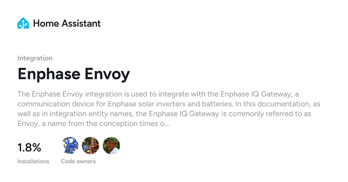

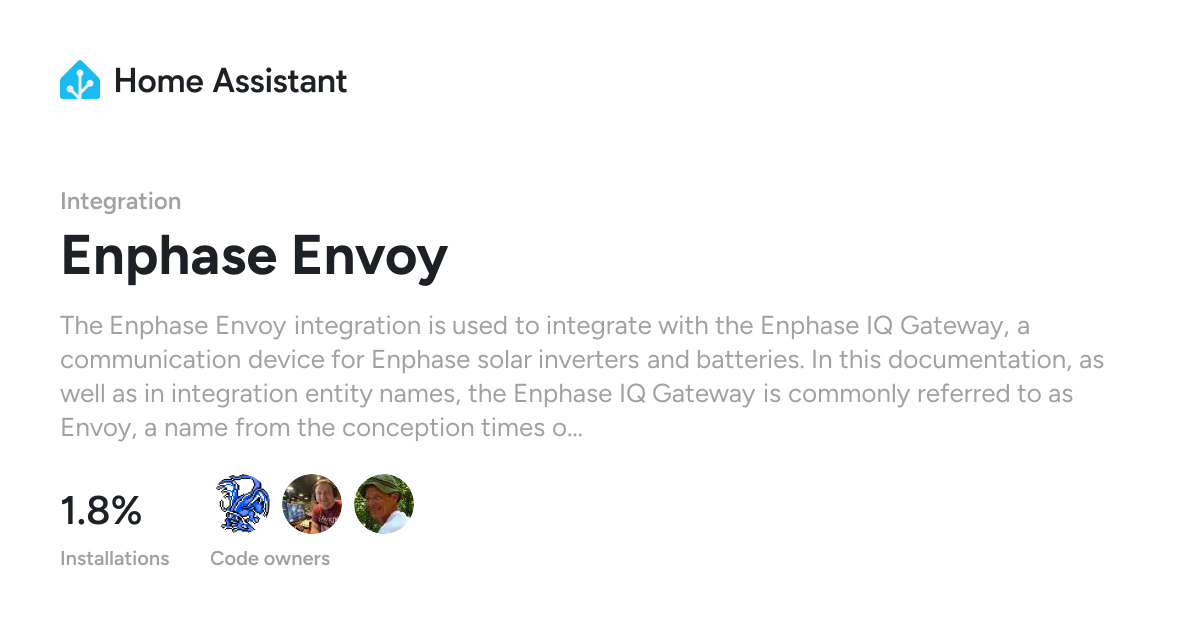

First I would go to that integration page again and click a different three dots -- this time the one listed on the right as a "hubs" or "devices" and look for "reload" and try that.
The reload option tells the integration to reconnect.
The host name should have been auto-discovered when first configured if you didn't manually enter it (according to the integration docs), so if "reload" doesn't work you could also remove the "hub" or "device" from that same menu and try setting it up again and hope that it finds the Enphase again.
Probably helpful to have a second window open and watch the logs when you try and restart or delete/add the integration again.
Oh, also look at this option: "Always use a new connection when requesting data from the Envoy"
