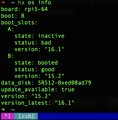

I had the same idea.
But even after updating to 16.1, my rpi5 still won’t boot from slot A.
Ok, had to reinstall.

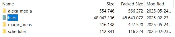

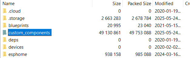

Didn’t know that this piece of fine software doesn’t backup HACS stuff.
It does if you tell it to do so when setting backups:
