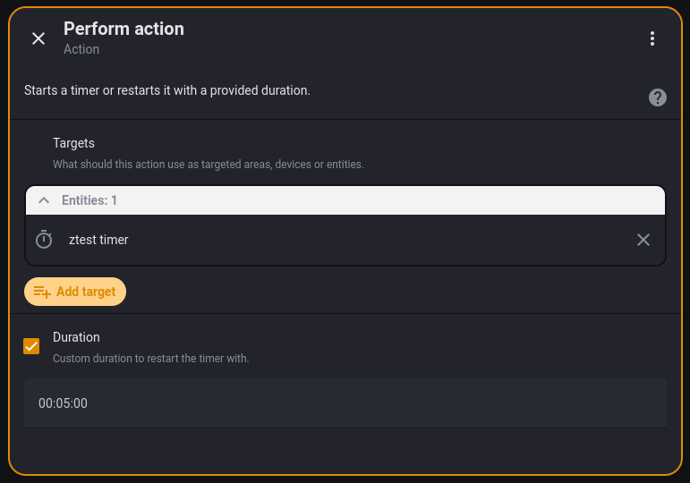

I think what you may be missing is that you need to create a Timer entity in the Helper menu first. The timer actions like timer.start that are found in the Automation editor require a Timer entity to act on. Once that is done, you just select the Timer under Target, check the “duration” box, and type in the duration:

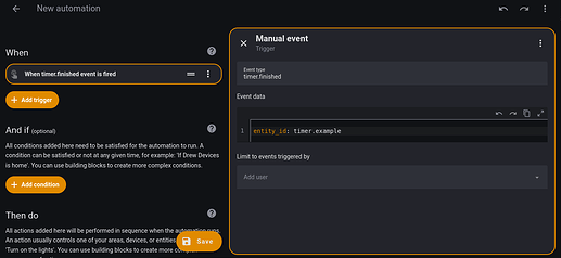

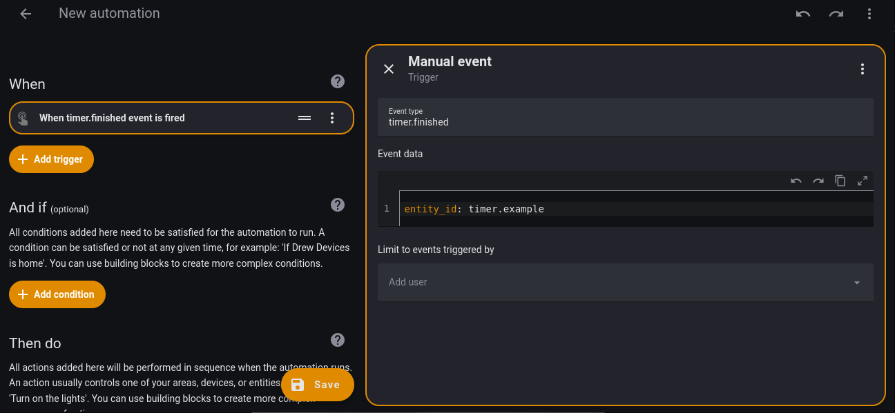

To trigger off a Timer, you will need to select “Manual Event” from the trigger options and fill in a little bit of information including the entity ID of the Time helper you created for this automation:

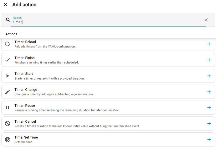

Where are you looking? There are all kinds of timer actions in the UI.

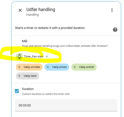

I have created a “helper” Timer_Fan.start.
Then I use this timer for my action:

Then I use the event to control it right ? I’ll have to figure out how to do it then :slight_smile:

timer.cancel
Or, if you have another automation that you want triggered when you manually finish it, you can use timer.finish.
