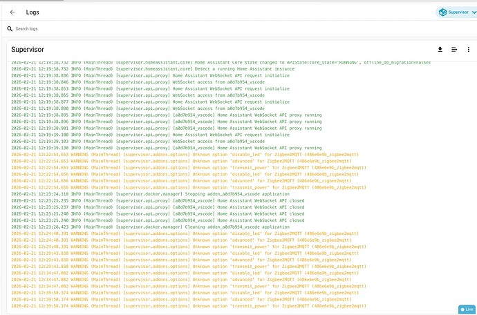

How to stop these Supervisor logs about z2m disable_led, advanced, transmit_power?
Good afternoon, these lines repeat like every 5 minutes in my supervisor log, understanding the impact is low to my setup. But I’d like to clean them up/stop them if not too difficult?
thanks in advance!
Jonathan
2026-02-21 12:22:54.653 WARNING (MainThread) [supervisor.addons.options] Unknown option 'disable_led' for Zigbee2MQTT (486e6e9b_zigbee2mqtt)
2026-02-21 12:22:54.653 WARNING (MainThread) [supervisor.addons.options] Unknown option 'advanced' for Zigbee2MQTT (486e6e9b_zigbee2mqtt)
2026-02-21 12:22:54.653 WARNING (MainThread) [supervisor.addons.options] Unknown option 'transmit_power' for Zigbee2MQTT (486e6e9b_zigbee2mqtt)
2026-02-21 12:22:54.656 WARNING (MainThread) [supervisor.addons.options] Unknown option 'disable_led' for Zigbee2MQTT (486e6e9b_zigbee2mqtt)
2026-02-21 12:22:54.656 WARNING (MainThread) [supervisor.addons.options] Unknown option 'advanced' for Zigbee2MQTT (486e6e9b_zigbee2mqtt)
2026-02-21 12:22:54.656 WARNING (MainThread) [supervisor.addons.options] Unknown option 'transmit_power' for Zigbee2MQTT (486e6e9b_zigbee2mqtt)
