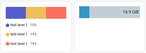

Anyone already figured out how to style new distribution card? I want to increase height of the bar itself, so it matches height of other bar charts I have on my dashboard. I tried something like:
card_mod:
  style: |
    .bar {
      height: 20px;
or
card_mod:
  style: |
    ha-card {
      --bar-height: 20px;
Even tried some other AI generated variations, but nothing works… Please advise!

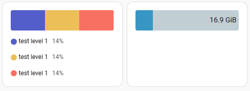

Try:
type: distribution
entities:
  - entity: input_number.test_level_1
card_mod:
  style:
    ha-segmented-bar $: |
      .bar {height: 48px !important;}
For a similarity to a custom bar-card, the height must be 40px:
and also tune up a top padding & border-radius for the bar-card for a perfect alignment.
Here it is - border radius for the bar card:
card_mod:
  style: |
    ha-card {
      --bar-card-border-radius: var(--ha-bar-border-radius,var(--ha-border-radius-sm));
and margin for the Distribution card:
card_mod:
  style:
      .bar {
        height: 40px !important;
        margin-top: 0 !important;
Works perfectly! Thanks a lot!
