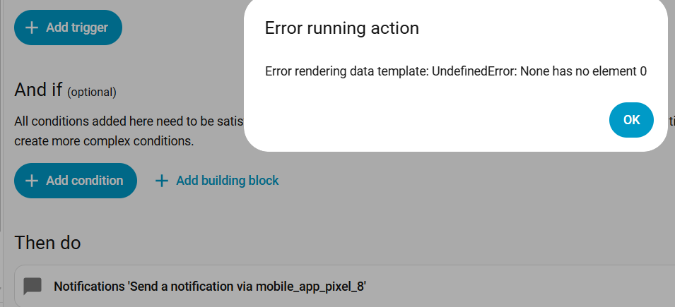

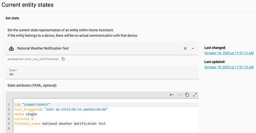

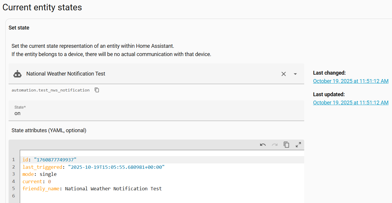

I did part of what you suggested already. I added a virtual switch as a trigger that I can flip. But when I did I didn’t receive a notification. Then I tried running the notification itself and got the error below.
Also, in Developer Tools → States it already indicates the NWS state is “on”. Should I change this then?

You’re assuming that alerts is a list with at least one element. The error message suggests that the value of that variable is none.

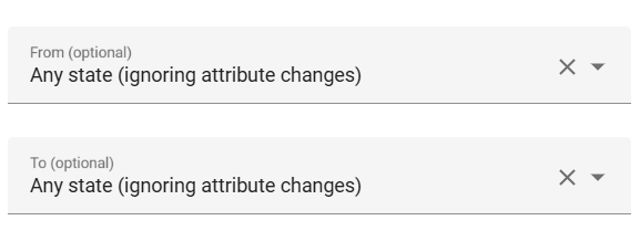

Your automation only fires when weather.ustn0365 goes from off to on. Are you sure that’s the exact transition that will happen when you have severe weather that you want to be notified about? That seems dubious… take a look at this page listing the states that a weather entity can take.
Thanks for the developer tools info. To answer your question, I was not sure of the off to on parameters. I just changed it to “Any state”. That seems like it should cover it, at least for testing purposes!

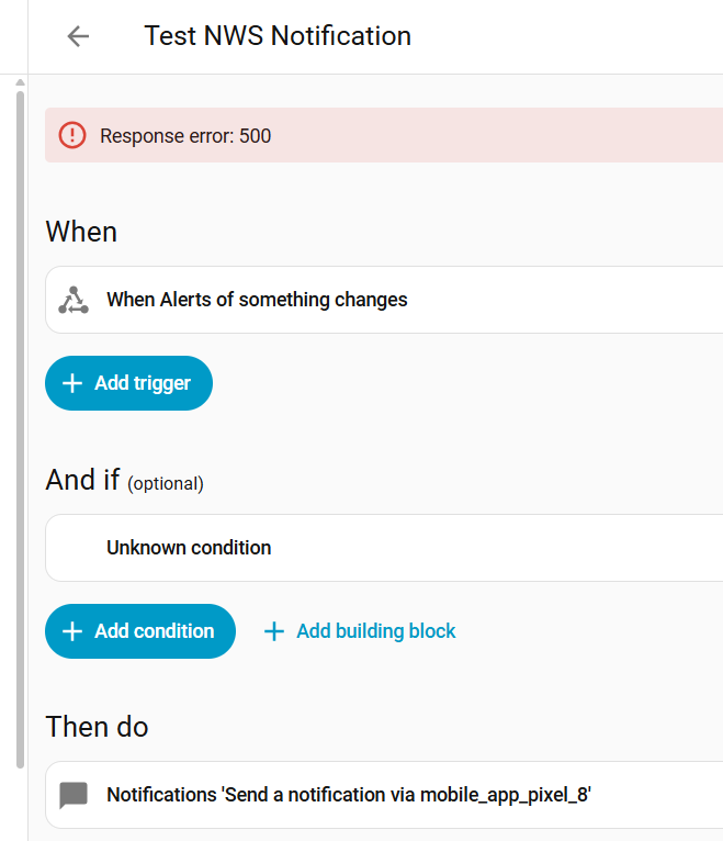

I copied and pasted your YAML into a new automation. But when I try to save it I get a 500 error.
Ha. I don’t use the GUI Automation editor, but presently I am getting that same error no matter what I try to do with the GUI editor, including if I try to create a simple automation based on the state of a light using the dropdown boxes.
