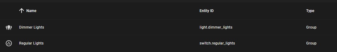

I created two groups in the helpers section, one for regular light switches and one for dimmer switches because my basement lights are on a smart dimmer switch and Home Assistant make it a light entity instead of a switch.

Check what the group is in entities. It should say what it is there
Might be switch.
My AllLights group from the group.yaml file doesn’t show up under entities. The two groups I created under helpers show up.
