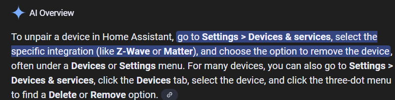

Good for you! I searched and only found threads about not being able to delete devices in HA. Evidently you are not away that you cannot delete a device from HA, which is what prompted my question. If you mean this answer, it does NOT work:

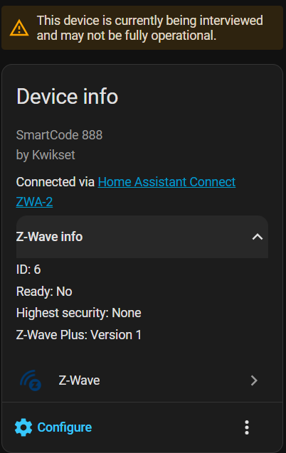

The default inclusion strategy used by HA and Z-Wave JS is to include locks with Security automatically. The only way your lock is not secure is if you manually included it without security*. Can you currently unlock and lock it in HA? If yes, you are using Security. It’s quite easy to look in the device page, expand the Z-Wave Info, and see what security level is reported.

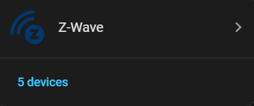

On step at a time. Click the blue “5 devices” link, and then click your lock device, to get to your lock device page.
What do you see? Poke around and you should be able to tell which security level you have got.
I did not explicitly include security, so it is not included. Wow, I just saw the “delete” option for the first time. I could not find it previously. A senior moment! Now from what I’ve read I need to pair it with the legacy security option in order to have to the ability to control the lock.

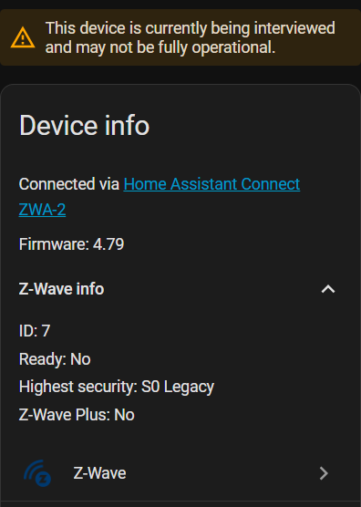

Got it thank you. I was able to remove the device and re-pair it using highest security. But as you can see it’s stuck interviewing. Hopefully it will complete the interview.
Update: All is well now, interview completed. Much more functionality with the legacy security.
