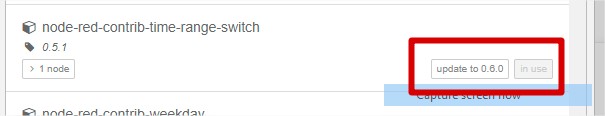

I’m running Node-RED with python HA. I’m using node-red-contrib-time-range-switch that has been very recently updated to fix a bug. Somehow node-RED is still showing the old version when github has the new one. I tried to update node-RED with no luck.
Is anyone know how the updated nodes are propagated to users? Also is there another way to only update nodes and not all node-RED on Pi? (I did not find anything else than that)
I had a similar issue and used the palette function in Node-Red to remove and re-install the node ( the update function did not detect the new version)
