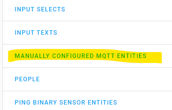

You’ll need to reload the configuration. Either restart HA or go to Developer Tools / YAML and click this one:
You should then have switch.pumpe available, assuming you have fixed the indentation (switch: should be a level below mqtt:, not on the same level).
