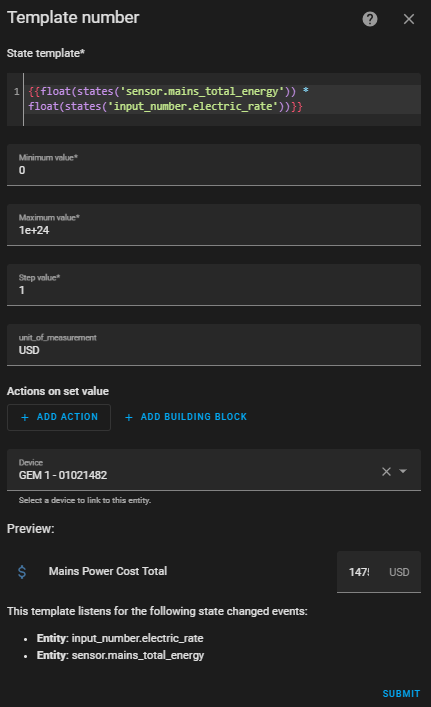

I am looking to make a number template for each circuit and major load.
I seem to be unable to use this entity in any statistics elements
I have found notes that this needs to be added to a template to enable
state_class: “measurement”
But that option is not available in the number helper.
I prefer to use the UI to manage these objects rather than 60-70 files. I assume this is just not exposed to the UI. Where are the files for helper definitions are stored so I can test adding it there?

A Template number is not a Template sensor… if you want statistics you need to use a Template sensor, which will give you the options to set device class, state class, and unit of measurement.

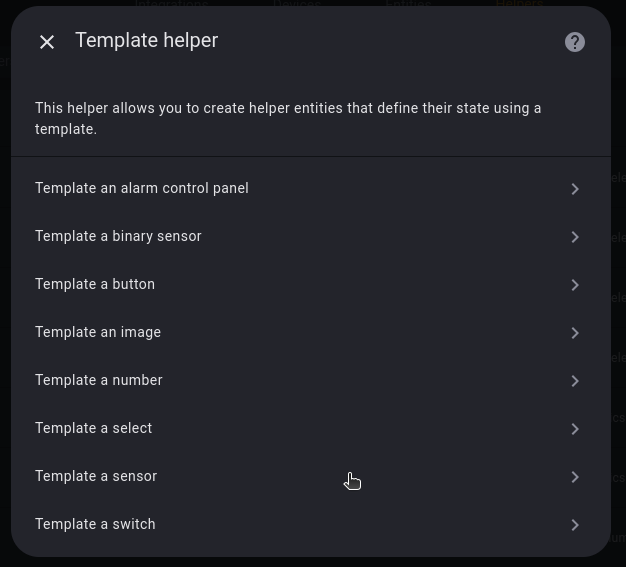

There is no “sensor” helper in the UI, then all this needs to be done via files?
There is… it’s two lines down from where you selected your Template number:

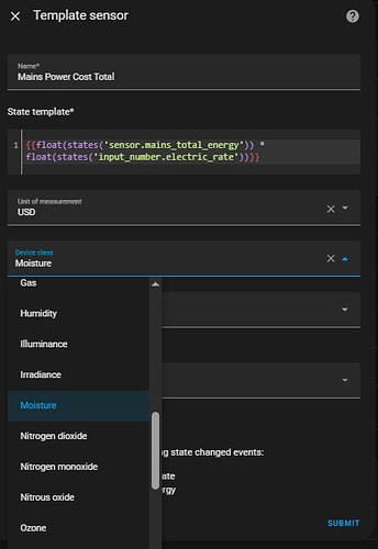

Monetary seems not to be available option, and it is not free typeable:

Read the post just above yours. You probbly missed it as we typed simultaniously. Monetary is considered a special device class. It might be filtered out there.
Interesting, so HA needs two separate Device Class, one for Monetary Rates (USD/L, USD/kWh) and a Real Monetary Total (USD,GBP,EUR)
No, Freck just needs to get of his high horse and see that monetary is a flexible term :slight_smile: But what you say could also help settle the dispute. I just keep avoiding monetary because it does not add much value until this is fixed.

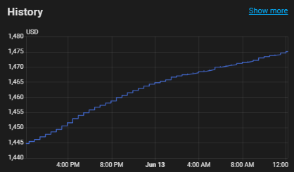

I created a template with no device class, Units USD, and State Class total Increasing.
It is recognized as a statistics sensor now for UI, without a device class.
Waiting for data to accumulate to test.

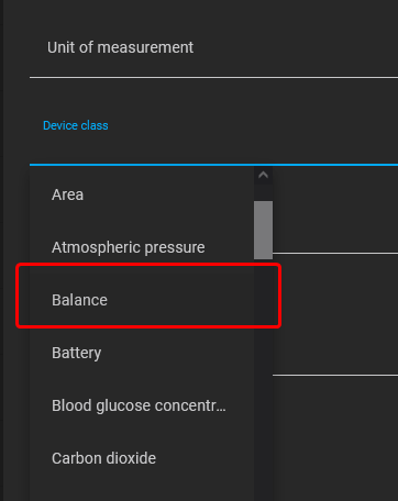

Monetary is translated to Balance in the UI.
