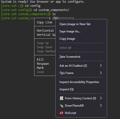

I am unable to paste commands into the browser-based terminal.
I tried CTRL-INS and SHIFT-INS. I also tried CTRL-V and CTRL-SHIFT-V. None paste the clipboard.
The right-click menu is also broken.
Two context menus appear, neither has a "Paste clipboard" function.
Is there a workaround, or should I ignore the terminal and just connect using SSH from another terminal program?
I use putty. Had exactly the same right-click problem (and an unwanted menu) with session sharing enabled. So perhaps try disabling it (share_sessions: false in addon/app configuration).
