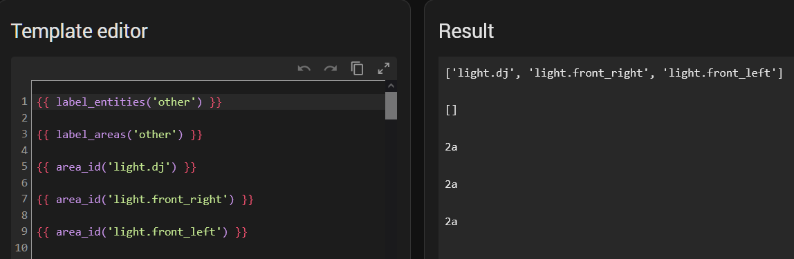

As I understand this should return the areas of entities with a specific label? I get empty results. Right now I am using 2025.11.0b1 but it was the same on 2025.10.04.
Are you sure you’ve added the label to the areas?
It returns the area IDs of all areas that have been assigned the given label.
label_areas(label_name_or_id) returns the list of area IDs tied to a given label ID or name.
Perhaps this is what you want. It lists all the areas containing entities labeled with other.
{{ label_entities('other')
  | map('area_name') | unique
  | reject('eq', none) | list | sort }}
I didn’t have a specific use, I was just testing to make myself familiar with it. I misunderstood the example.
