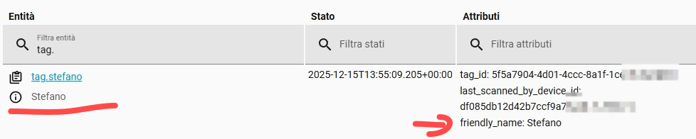

I’d like to ask you if there’s a way to retrieve the ‘friendly_name’ after scanning the tag.
I’ll explain what I did…
I registered a tag on HA with the name Stefano.
I created an automation of the type
trigger: event
event_type: tag_scanned
in actions: that should display the tag name, and I tried this:
"{{ state_attr(trigger.event.data.tag_id, 'friendly_name') }}"
But it doesn’t work.
Do you have any suggestions?
Thanks
I’ll answer myself, I had to write
"{{ trigger.event.data.name }}"
or you use a state trigger like
trigger: state
entity_id: tag.stefano
not_from: unavailable
and then you can use {{ trigger.to_state.name }}
