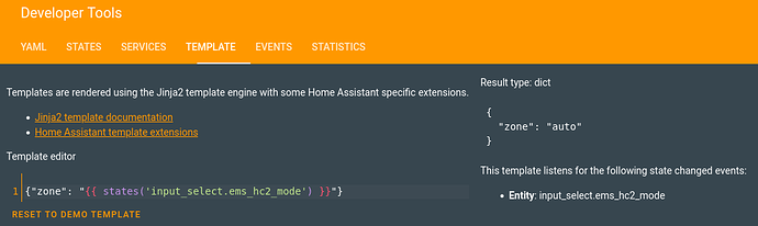

If i try your code (with one of my input_select’s) in Dev Tools/Templates it returns a dict.
Welcome to HA, btw! :slight_smile:
It’s because of what VDRainer is showing. All Jinja templates result in a string, always. HA though has made them smarter by converting things which look like a number, boolean, dictionary or array into their actual types.
Most of the time this is extremely convenient! However this is a case where those smarts backfired. HA sees that your result looks like a dictionary and so it turns it into an actual dictionary (like in VDRainer’s screenshot). But the message input was expecting a string so now its confused why you gave it a dictionary.
