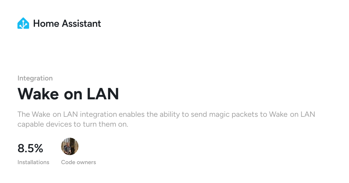

For Linux there are ssh command instructions in the WoL documentation: Wake on LAN - Home Assistant
