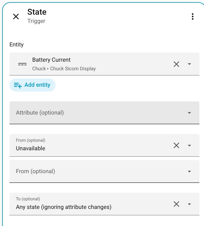

Just pick any entity in the device and add a state trigger that fires when it changes from "unavailable" to any state.

There is the [status binary sensor[(Status Binary Sensor - ESPHome - Smart Home Made Simple) that should be exactly what is needed. It should only be on when the device is awake and connected - at other times it will be off or unavailable.
Thanks @clydebarrow - your second suggestion works perfectly.
