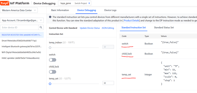

I looked in the tuya IOT portal for the debug info on this device, and theres only switch, child lock and set temp

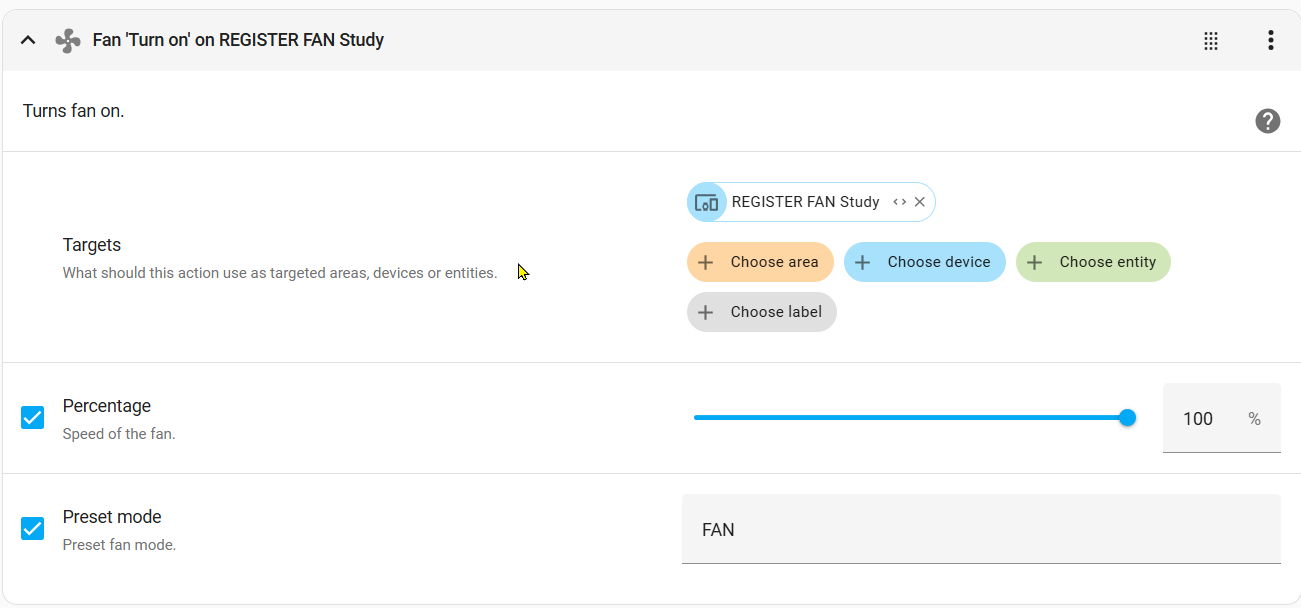

With regards to changing the blower speed, I added a register fan device to my dashboard (for me, the device is fan.register_fan_study). I can open it and change the fan speed, and even the mode (picture below). Raise or lower the center line for fan speed, scroll down for the mode switch). These all work from the dashboard.
I tried creating an automation with it, but unfortunately the only part of the automation that works is to turn on the device. It ignores any mode and/or percentage setting. Screen shots of the automation (in UI and yaml below)
It would be great if somebody would have a suggestion on how to set the fan attributes. That would really be fantastic!

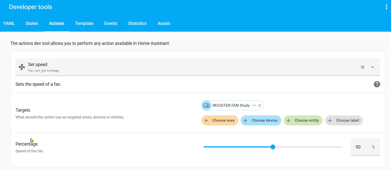

OK - figured it out. It is totally possible to adjust the fan speed.
The code is as follows:
action: fan.set_percentage
percentage: 50
device_id: 41d88ed8901ad456395305a09c93710f
Visually, as below (using the developer tools):
