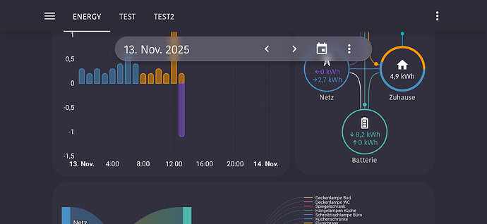

I used some hacks to get the energy date picker card into the toolbar in the past.
But this didn’t work reliable over time, and I started to use multiple time pickers on the same dashboard to look at daily ranges at top and monthly / yearly ranges further down the dashboard using multiple energy collection_key values.
So I needed some way to keep different date pickers pinned to the screen based on scroll position.
With card-mod 4 I finally managed to keep the date picker of the current section pinned to the top of the screen.
Thanks a lot to @dcapslock for the help. :slightly_smiling_face:
See this video demo:
This makes it easy to change the date, without the need to scroll to top for the date picker all the time.
You might need to adjust the colors / shadows to match your theme.

Not sure if the video loads correctly from anywhere.
Here’s a screenshot how it looks when scrolled down and the date picker sticks below the top toolbar when the dashboard gets scrolled down:
