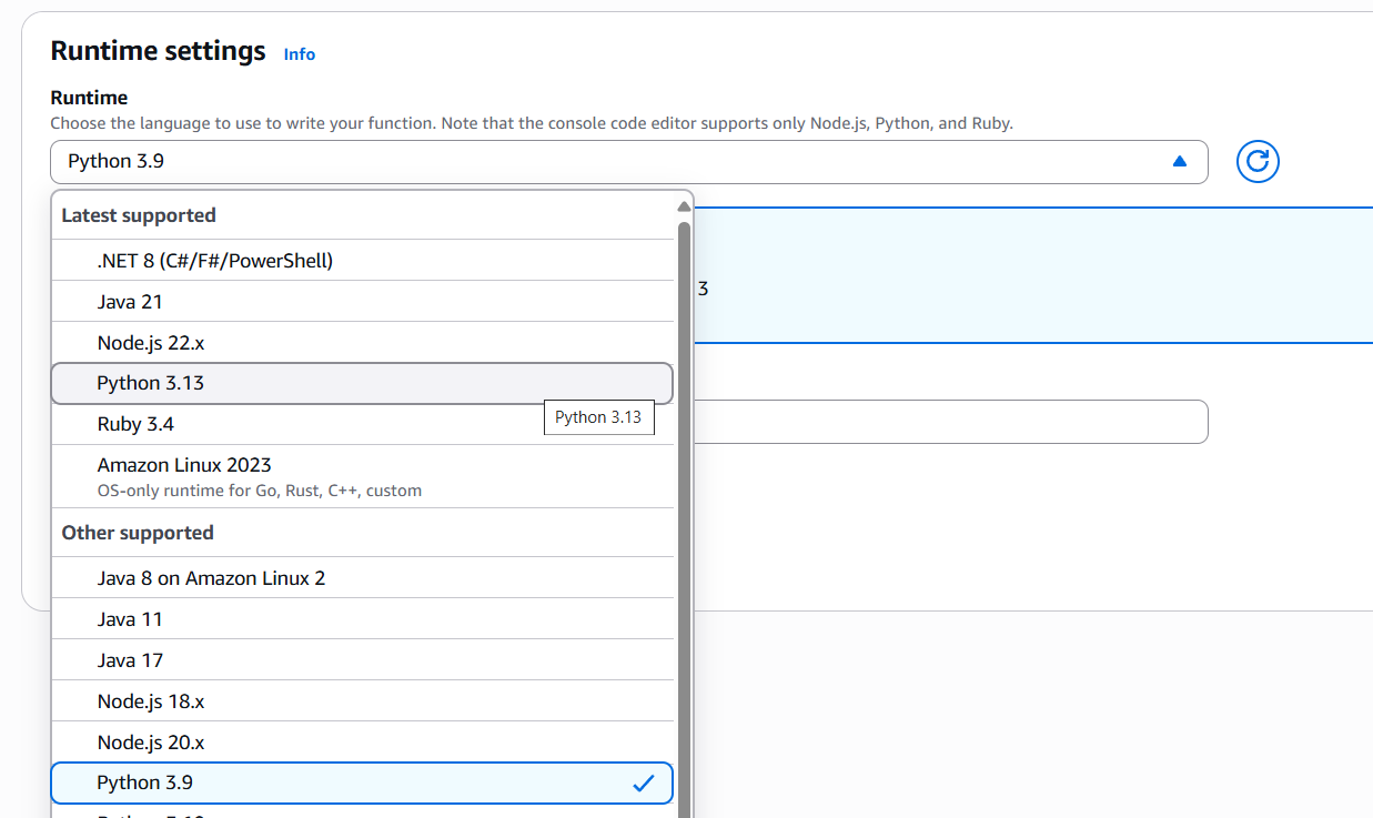

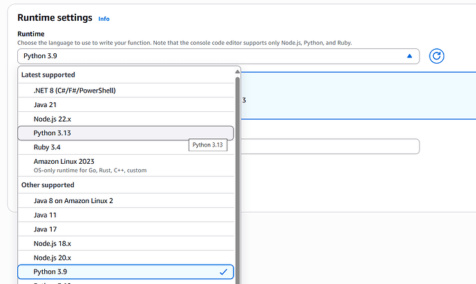

morning all - just received notice from AWS that they’re retiring the version of Python I’m using in Lamda and I only use if for this I believe (been a long while since I set it up or changed anything!)
Any concerns with updating the Python version and making no other changes?
