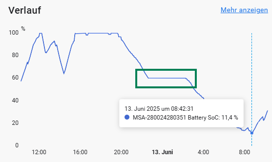

First automation I did was to delay discharging at night to reach the lowest shortly SoC point shortly before charging again.
Pretty static in the moment, needs improvements, but a good example to show how the MQTT interface works.
Further Ideas:
Prevent discharge under 100W, as the efficiency is really low in that range.
alias: MSA discharge stop 60 %
description: Stop discharge at 60% and start discharging again 3 hours before sunrise and more than 4kWh production predicted

Worked quite well, battery was discharged to 11% and then the solar energy production was high enough to charge the battery again. The green rectangle highlights the time the automation is active:

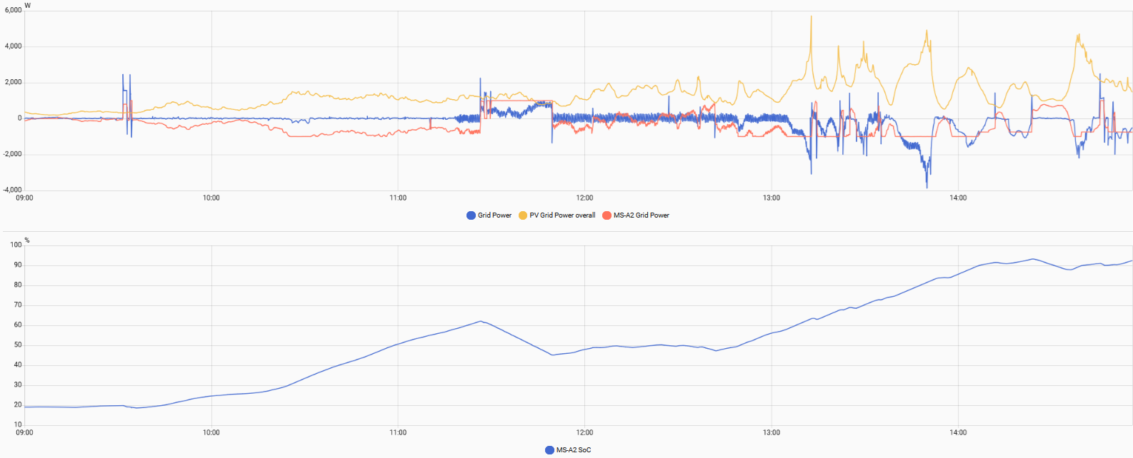

thank you @skipper22hassio - I think about an automation that not use the standard way between MS-A2 and Shelly 3em, so HA could control. You could ignore a specific Phase, for example.

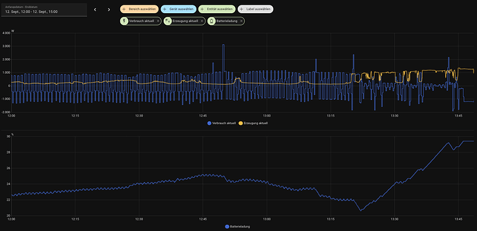

Exactly. I’m also trying to automate one phase, but something’s not working.
Same in my case - my automation is jumping to much. Maybe someone has a good idea

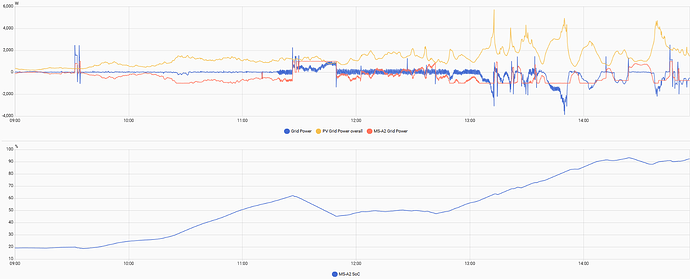

I also had the problem of oscillating power of the MS-A2. I added a moving average filter with 8s window to both, the domestic power meter and the “quick.state.grid_on_p” sensor.
Maybe a shorter window is possible, but the reaction is realy quick already.
In my setup, the Hoymiles MS-A2 is just plugged in with “Grid On”; no inverted attached directly.
I created a template sensor to control the power target of the MS-A2.
“grid_power_for_ms_a2” is the domestic meter’s power reading (via Tasmota Hichi IR) filtered with a moving average filter with 8s window width.
“ms_a2_grid_on_power_filtered” is homeassistant/sensor/MSA-xxx/quick/state also filtered with moving average 8s.
The various input_number entities are named self-explaing, I hope.
Template sensor for the MS-A2 power target.
{# negative is charging, positive is discharging #}
{# lower then +-9 is pratically off #}
{% set grid_power = states('sensor.grid_power_for_ms_a2')|float %}
{% set msa2_power = states('sensor.ms_a2_grid_on_power_filtered')|float %}
{% set chargeLim = -(states('input_number.ms_a2_charge_power_max')|float) %}
{% set dischargeLim = states('input_number.ms_a2_discharge_power_max')|float %}
{% set pwrSet = grid_power+msa2_power-10 %}
{% if (pwrSet < -10) and (states('sensor.ms_a2_soc')|float > 95) %}
  {# stop further charging #}
  {% set pwrSet = 0 %}
{% endif %}
{# add deadzone with on/off hysterisis and saturate to limits #}
{% if is_state('sensor.ms_a2_state','standby') and (pwrSet > -50) and (pwrSet < 50) %}
{% elif (pwrSet > -30) and (pwrSet < 30) %}
{% elif pwrSet < chargeLim %}
  {% set pwrSet = chargeLim %}
{% elif pwrSet > dischargeLim %}
  {% set pwrSet = dischargeLim %}
{% endif %}
{{ pwrSet }}

“sensor.ms_a2_power_ctrl_random_offset” is a random number helper with values 0-50. This results in a minor variation of the setpoint and makes the MS-A2 keep listening to the mqtt commands.
Next step could be to add a cheap-grid charging case.
Works quite good. The oscillating grid power 11:00 to 13:00 is the wasching machine’s motor.

May I ask how the update frequency of your origin sensors is? I set up your solution for me, but e.g my Tasmota Hichi IR is sending new values every 10 seconds, while MS-A2 sends new values every second.
Furthermore, unfortunately, my values are oscillating pretty heavy:
Any idea why this is the case?
