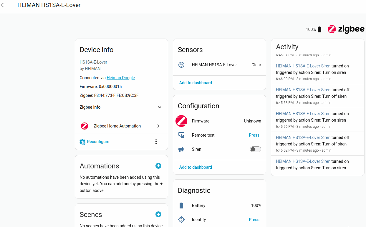

It has supported with both of Z2M(2.10.1) and ZHA(HAOS 2026.7).

Didn't receive any files with the message, I bought my device just now but can't read the data in dev console
you need to wake up the device while reading, use a pin to press the button on the side of device.
I tried lot of times, didn't work! :confused:
how about press the test button? it should wake for 3 seconds, please click read on HA and press the test button.
Didn't help! Tried all options but can't read.
