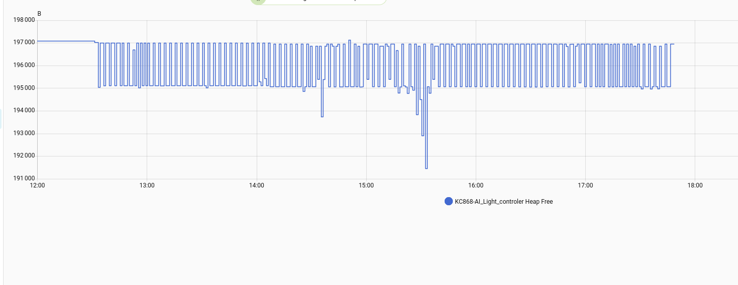

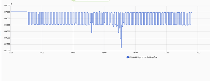

The heap
At the resquest of someone on the discord, i ran it with usb serial, to see if anything showed up after the error but couldn’t be seen because of a network issue.
Sadly, no

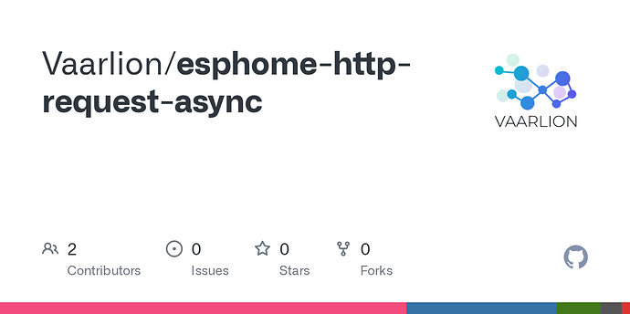

i've heard it's fixed, but i made this if you still have your usecase @PvdGulik.
it make all http call using async, you can make multiple at once even.
I should be a drop in replacement.
