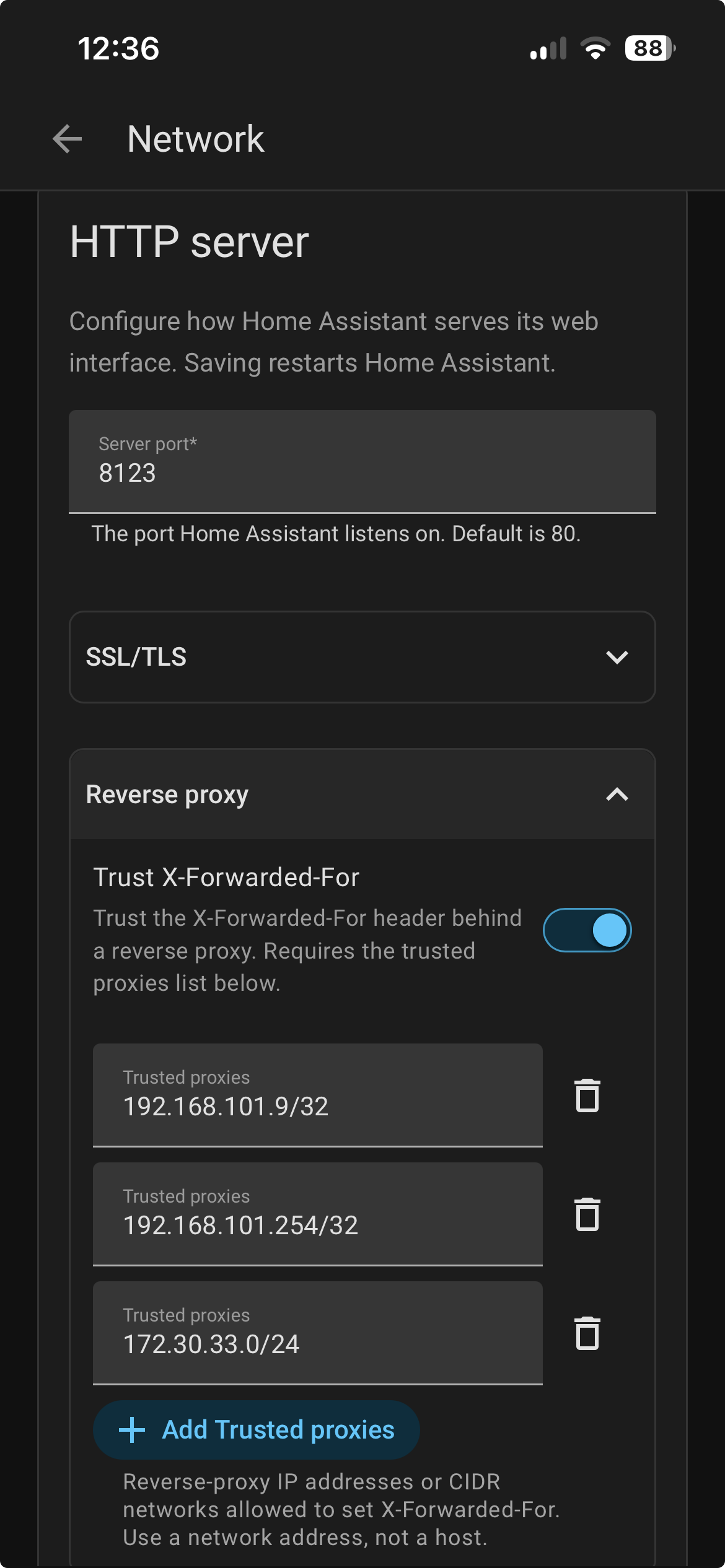

Running HomeAssistant 2026.8.2 via docker, after getting the deprecation warning, I’m not seeing this Server configuration or the ability to add trusted proxies.
Is this an oversight, or is there no way to add a trusted proxy configuration in the docker version? Or was it moved to a different place for the docker version?
Clear your cache and refresh the page
EDIT: @petro’s response is the answer. Clearing cache and refreshing the page fixed it. Thanks!

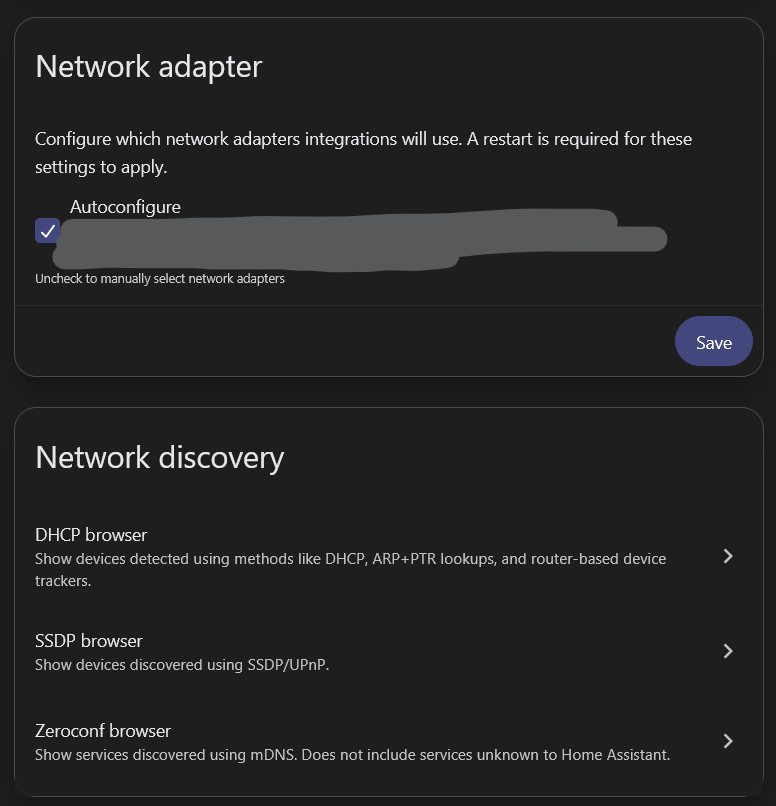

@trisweb I’m running HA in Proxmox and have the same issue. Running 2026.8.2 and have the deprecation warning but no HTTP server settings under network (see screenshots below).
@aceindy, can you point out where those HTTP server settings in your screenshot are meant to be?
@JAGCONdev
/Settings/System/Network
