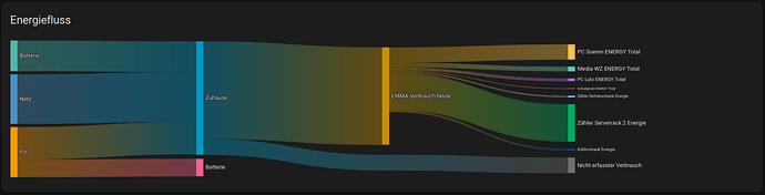

The question is also similar but not identical: How can I get the energy dashboard to show the same values as the Online Dashboard from Huawei itself is showing. Below you will see example values from yesterday (2026-01-24).
HA Energy Flow:
I don’t understand what the unrecorded consumption here is because the value “EMMA Verbrauch heute” contains the total consumption of the house for the day. Also it is quite sad that due to the need to put all devices behind the total consumption the graph doesn’t show the configures stories and rooms anymore.
HA Total Energy used per day vs Huawei Total used per day:
The difference of 17,4kWh (HA) and 14,97kWh (Huawei) is too big to ignore. This is my main pain point!

This topic is solved. I didn’t see the following page of the Huawei Solar Add-On: Daily Solar Yield · wlcrs/huawei_solar Wiki · GitHub
