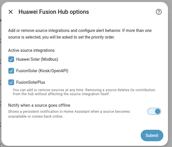

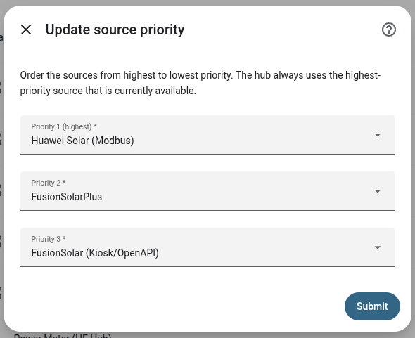

Huawei Fusion Hub sits in front of up to three source integrations — Huawei Solar (local Modbus), FusionSolar (Kiosk/OpenAPI) and FusionSolarPlus — and exposes a single stable set of sensor.hf_hub_* entities with automatic priority-based failover. When the local connection drops, the hub transparently switches to the next available source. Your automations keep running.
Key features:
  • Priority-based failover, configurable from the UI at any time

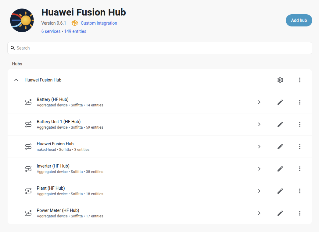

  • 221 canonical sensors grouped into logical devices: Inverter, Battery, Battery Unit 1/2, Power Meter, Plant
  • Stable entity IDs regardless of which source is active
