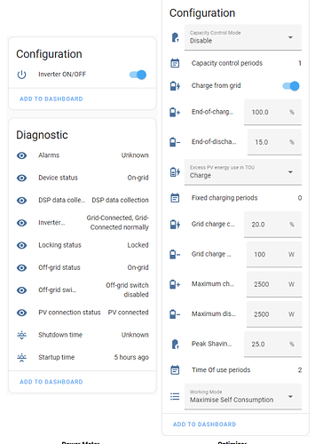

But I am missing the configuration options like visible in following screenshots
Please can me someone explain how I can activate/get this configuration options?
Did you select 'advanced: elevated permissions ’ when configuring the integration? I believe you need to have specific rights to perform the actions shown on the screenshots.
