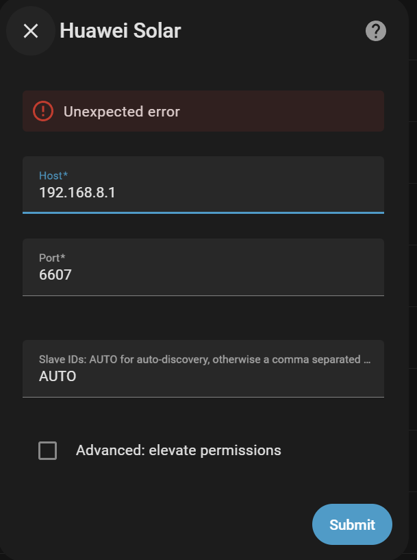

I have a SUN2000-10K-LC0 and I am not able to connect to it using the Huawei Solar integration.
I am using a router (with OpenWrt) as a bridge to the SUN2000 built-in AP, NAT-ing 192.168.8.0/24 (the Inverter is on 192.168.8.1 in the AP networks). TCP/IP connectivity seems to work:
  • I can successfully ping 192.168.8.1 (the Inverter) from devices on my 192.168.1.0/24 LAN (including from my Home Assistant Green and from my Win11 PC)
  • I can successfully connect to port 6607 through the bridge (“Test-NetConnection 192.168.8.1 -Port 6607” returns True on my PC)
  • there is no answer on port 502 (or 80 or 443), even when connected directly to the SUN2000 built-in AP, so port 6607 seems to be the correct one.
However, when I try to add the device, I keep getting an “unexpected error” or “reading from the inverter failed” after several seconds of waiting time. I tried Slave IDs: AUTO, 0, 1, 2 and 3, with and without “elevate permissions”

update: I also tried a USB WiFi adapter directly connected to by Home Assistant Green. Same results:
  • I can ping the inverter on 192.168.8.1 from HA Green;
  • I can connect to port 6607 on 192.168.8.1 (but not to 502);
  • When I try to add the device, I keep getting an “unexpected error” after several seconds of waiting time. I tried Slave IDs: AUTO, 0, 1, 2 and 3, with and without “elevate permissions”.
It really seems that this version of the inverter and/or Firmware is not supported by this integration.
