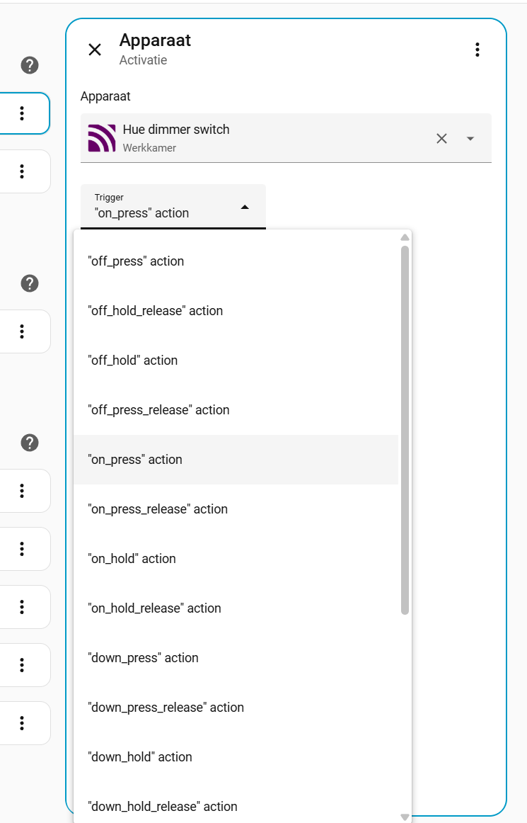

I don’t use the Hue app anymore. Connected all zigbee lights to HA using Zigbee2MQTT and a Sonoff Zigbee dongle.
You can select any action from the Hue dimmer switch:
