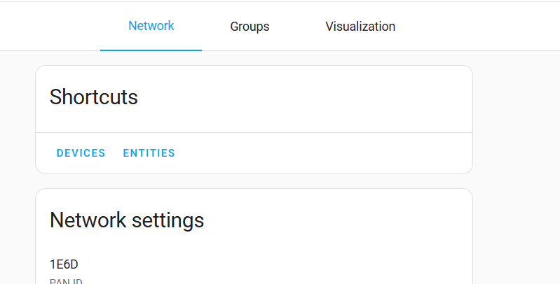

then your ‘mesh’ needs some help. Can you see the device on ‘visualisation’ in ZHA configure subscreen?
It’s there (blue) and the red one is a motion sensor, which I see I have to repair again too.
