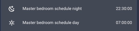

Getting there:
using these templates to derive from your json sensor:
34
I can create sensor.master_bedroom_schedule_morning and sensor.master_bedroom_schedule_evening
Would this allow for using these in my automations and substitute the current hard coded time:

ok, update on my search for the schedule times, I got this far, thanks to @pnbruckner 's command_line sensor support :
49
using:
- platform: template
  sensors:
    master_bedroom_night:
      friendly_name: Master bedroom schedule night
      value_template: >
        {{states('sensor.master_bedroom_schedule')[2:-11]}}
    master_bedroom_day:
      friendly_name: Master bedroom schedule day
      value_template: >
        {{states('sensor.master_bedroom_schedule')[12:-1]}}

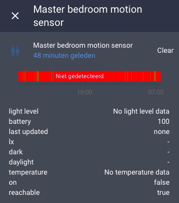

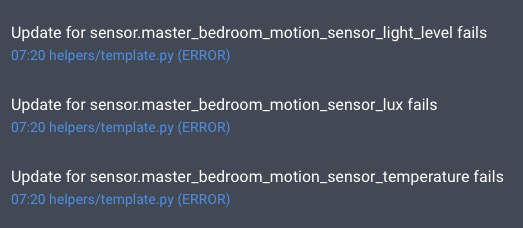

reason for this intermediary post is an issue though, several of the CC’s attributes are not created (though presence battery, on, and reachable are unaffected) and hence the template sensors create errors in the log:
16
and:
16 23 29
10
question for @robmarkcole and @yottatsa if this is to be expected? does my extra command_line sensor frustrate the CC? And if yes, could I prevent this is any way?
thanks for having a look!
just to be sure I tested 3 extra times, and can report it is consistent: each time I take out the |jq command line sensor, all attributes are there. use the |jq command line sensor and the attributes are gone.
maybe this way of pulling out the wanted data can be change into a
value_template: >
    {{value_json.state.value}}
after all, and that wouldn’t hurt the CC sensors creation?
EDIT 2
changed to _X GET and now it works fine!:
master_bedroom_schedule: curl -X GET http://192.168.1.212/api/API/rules/20 | jq ‘.conditions[]|select(.address == “/config/localtime”)|.value’
can’t find the documentation on the -X GET necessity but will find out later.
_UPDATE_3
seems still a bit flakey, template sensors don’t always get created, and are only created when the motion sensors is set to on. Dint understand this at all yet… somehow the command_line sensors interferes with the regular CC created sensors, and their template sensors.
