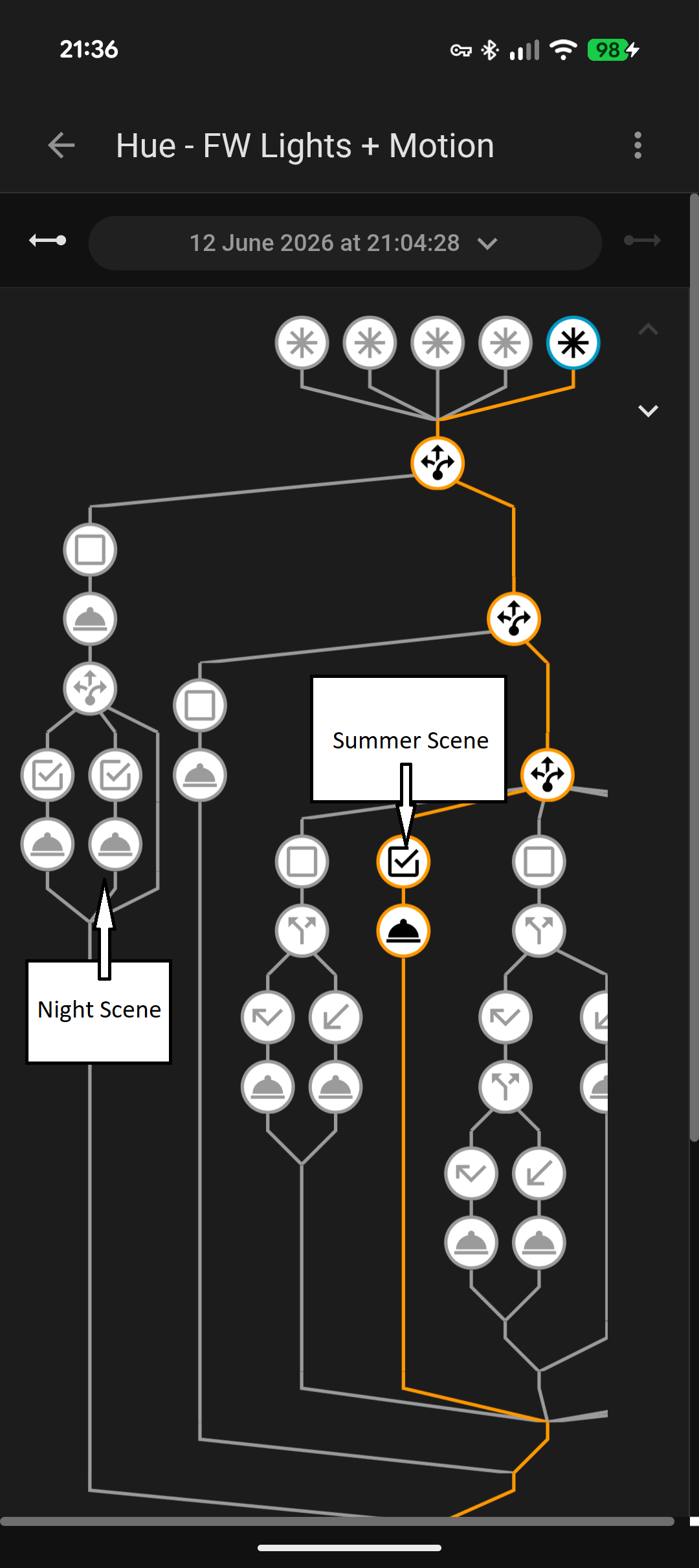

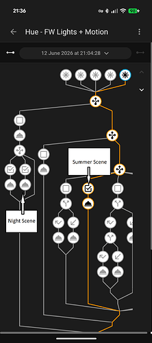

Look at your automation traces.
So, the traces show things are being requested properly. It's just not translating to the correct lighting scene being selected.

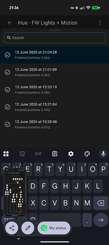

And it is not like there is a double trigger happening?
look at the timestamps on the traces.
It might be that one is triggered and then next is triggered almost at the same time?
If there is no double trigger, then test it in the Hue app and see if that acts differently.

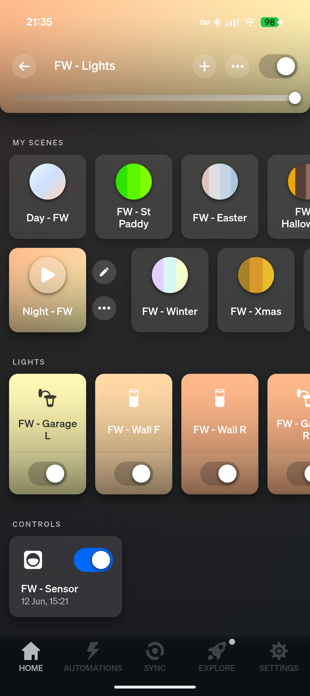

Sorry this took me a few days. This is the last trace from a few nights ago. No sign of a double trace, as you can see below. Also, as you can see, the night scene was selected in the Hue App.
I did try to activate the summer scene via Home Assistant manually, and it worked fine. Showed up in the Hue App, and the lights were correctly coloured.
And selecting the scene in the Hue app also works fine.

Well, then the steps in the trace should also tell you what is sent to Hue and if that is correct, then the error might be in the Hue part.
