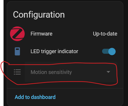

Hi guys,
I’m using Philips HUE motion sensors with ZHA. I think I was able to adjust motion sensitivity earlier, but now that control has been grayed out. When I select “Motion sensitivity” in the configuration, a pop up says “This entity is no longer being provided by the zha integration. If the entity is no longer in use, delete it in settings.”.
How can I fix this so that I’m able to adjust the sensitivity of the motion sensors in my automations? My cats are driving me (and my lights) crazy…

Thanks @bob.t but the issue is not related to a specific Hue motion sensor. The issue applies to all my Hue motion sensors added via ZHA.
I can confirm the same and it applies to indoor and outdoor Hue motion sensors of which I have multiple:

This issue seems to have been introduced in 2026.2. In my case, everything was working. I updated to 2026.2 and now I see the same issue that you are reporting with all my hue motion sensors. I googled it and It seems it has happened before with previous HA updates breaking the same motion sensitivity parameter in ZHA. I guess we have to wait for an update that fixes the issue.

Thank you @willliamchan for reporting it! It seems it should get fixed with tomorrow’s update. Looking forward to it.
Yay - motion sensitivity configuration is available again after the update :slightly_smiling_face:
