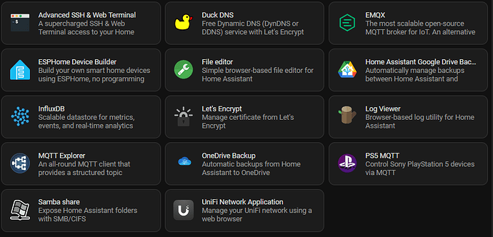

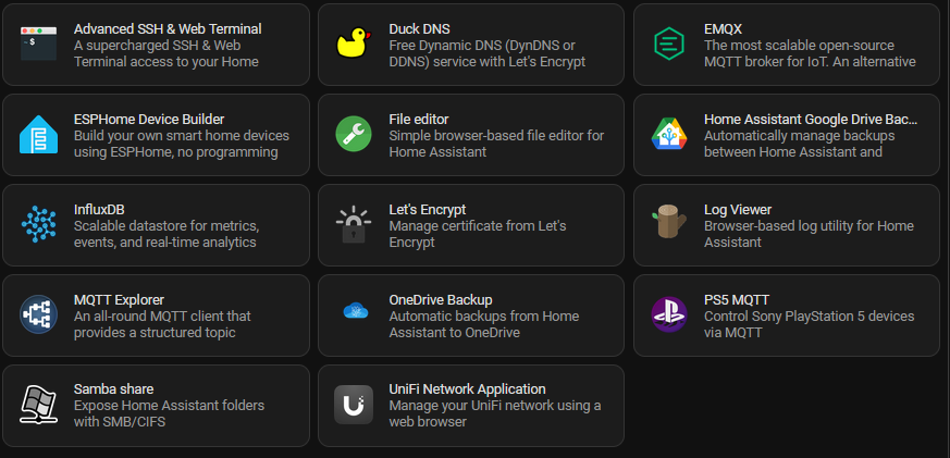

@jackjourneyman - Hi - this is the list addons in the system:
