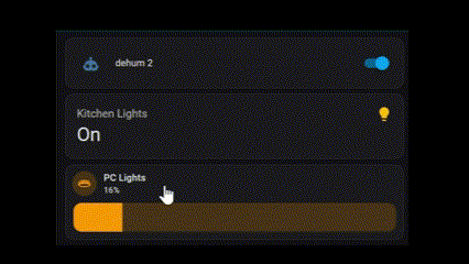

Heck test it with a light as the trigger using the brightness attribute
alias: dehum 2
description: Turn on dehum when above 50% humidity for 10 minutes, off below 48%
triggers:
  - entity_id:
      - light.pc_lights
    for:
      hours: 0
      minutes: 0
      seconds: 5
    above: 50
    trigger: numeric_state
    attribute: brightness
  - entity_id:
      - light.pc_lights
    for:
      hours: 0
      minutes: 0
      seconds: 5
    below: 20
conditions: []
actions:
  - target:
      entity_id: switch.kitchen_lights
    action: switch.turn_{{ trigger.id }}
mode: single
Did you read the link Sir-goodenough posted? Did you understand it?
Aer you serious? Did you test the example automation I posted? It works fine so please explain your point with additional facts.
Untitled video - Made with Clipchamp
It wont, if the humidity is above 50 when you restart HA it will not run. If the lights are on when HA restarts and the humdity is less 20 the lights will stay on. If your sensor becomes unavailable whilst the threshold is past in either direction the automation will not trigger. But hey if you insist on doing it that way feel free.
