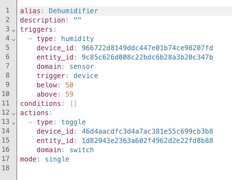

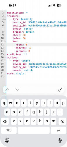

The automation that I have written does not seem to function. Trigger being humidity change with high and low limits action being toggle Tapo plug.
Share said automation.
I can take a guess, but you will get better answers if you post your properly formatted (</>) YAML. Automations #1: trigger only fires when it changes from not true to true
Yes I understand but was unable to find a function that would hold the trigger. My 1st foray into HA so learning. Thanks for yr help
If the sensor value is between 50 and 59 (or above 59 or below 50) there will be no triggers. The sensor value has to pass thru the limit to generate a trigger, as my link states. So if you are not getting a trigger but think you should, that could be the reason.

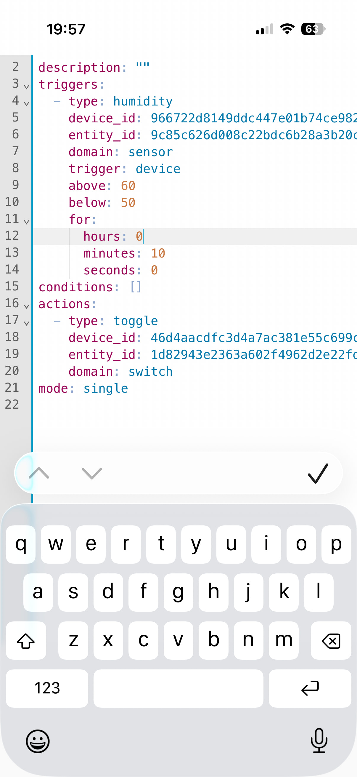

I can’t figure out how to post my yaml. Just shows up all scrambled. Hold. I posted screenshots.

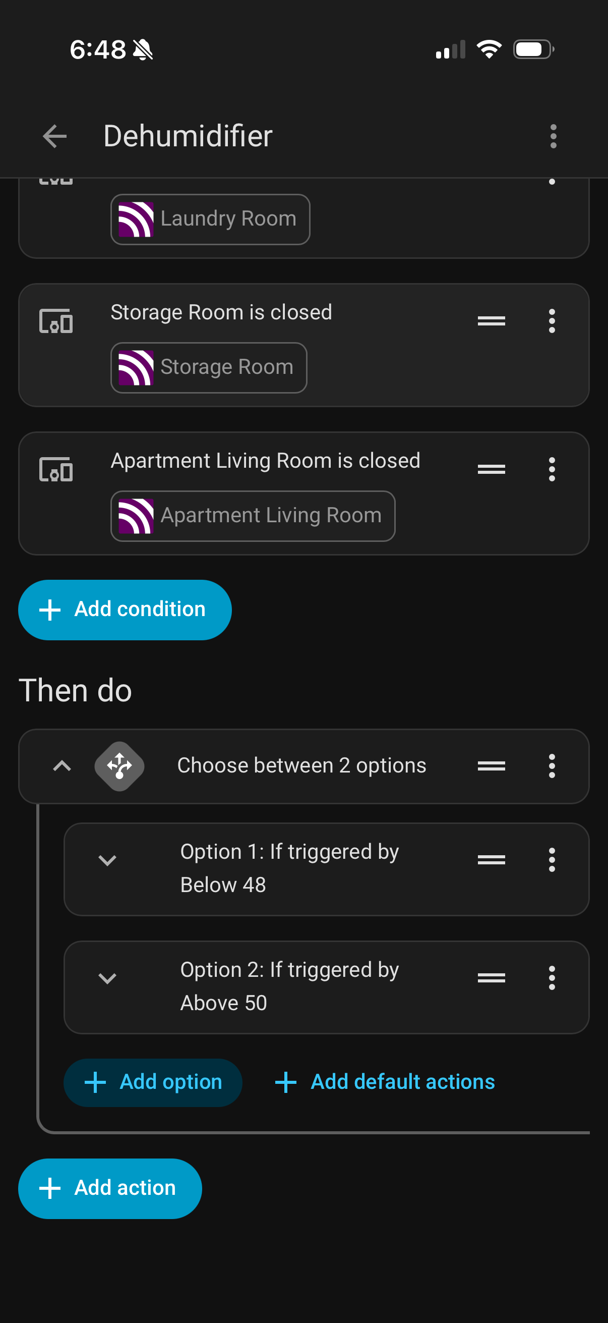

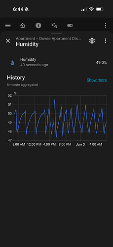

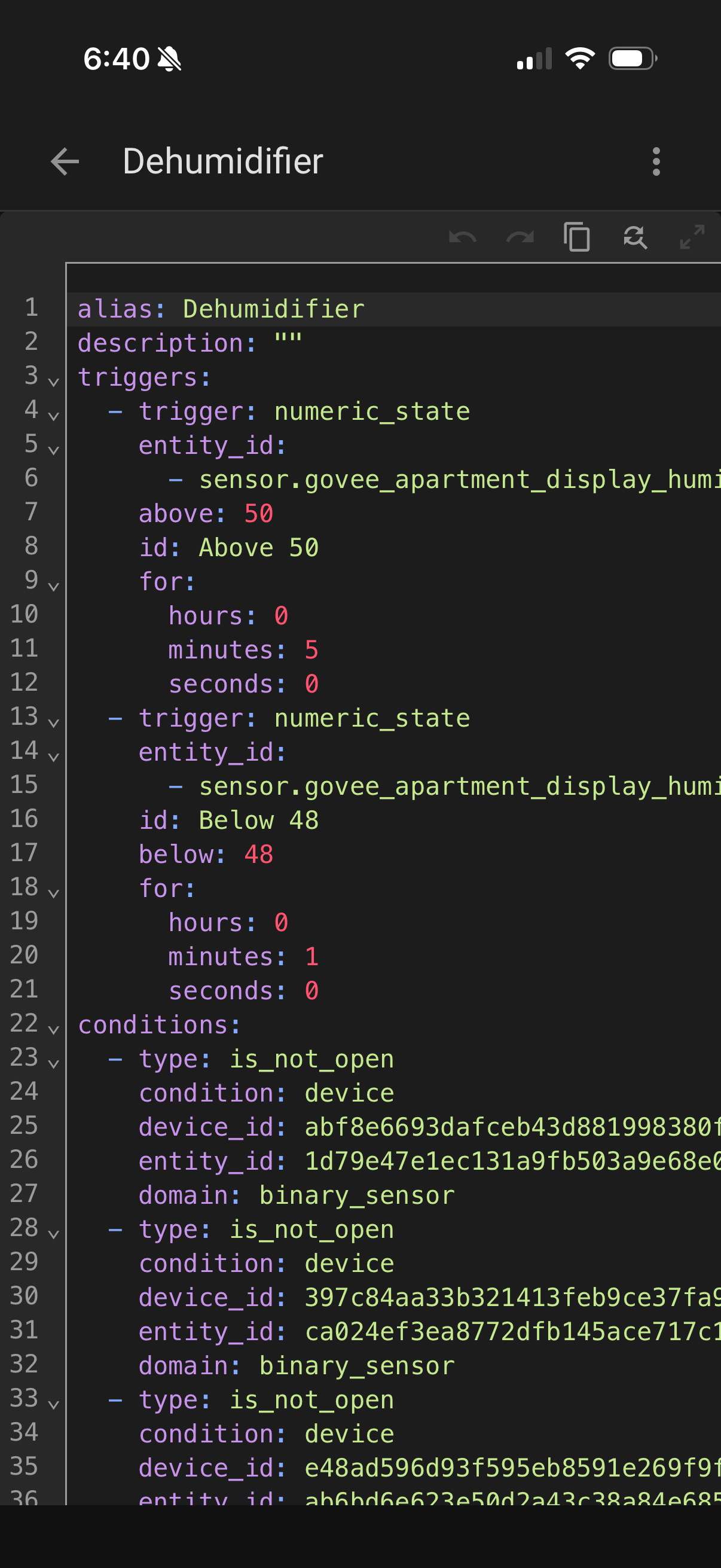

I have mine turn on at 50% then off at 48%. I also make sure the windows in that area are closed before it turns on. I’ve dehumidified the outside too many times now so I added that recently.
Above 50 is 1 trigger with a trigger id Above 50
Below 48 is 1 trigger with a trigger id Below 48

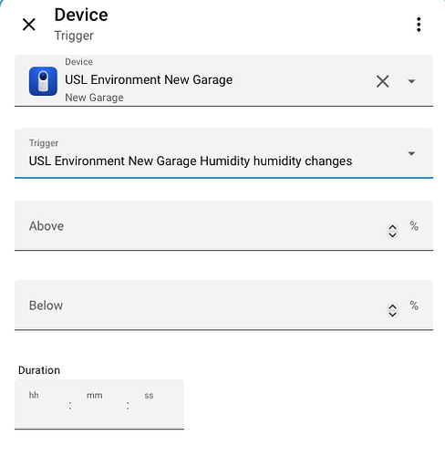

Not getting any further with this. It is my 1st automation so I may have done something wrong. Automation does work when manually triggered. but does absolutely nothing when left to be automatic.I have tried a separate on and off as well as the Unifi one shown without any success. Humidity displays correctly. Need to go through it from the very beginning I think
As you have it now, it says toggle the switch when the humidity is both above 60 and below 50. That can’t be true at the same time. So it will never run. As it can’t be both 61% and 49% at the same time.
Make a new automation that says when it’s above 60%, turn ON the switch
And then another new automation that says when it’s below 50, turn off the switch.
Manually running an automation isn’t a good test to see if it works. Because in this case, when you manually run it, it says ok, he believes this needs to run and jumps straight to the actions. It doesn’t stop to verify the triggers. You pressing Run, was what triggered the automation so it will simply just run the actions.
I would suggest you try using a generic hygrostat helper instead. I have a feeling it will be far easier for you to understand and configure properly.
firstly the trigger parameters are what is asked for by home assistant so I simply fill in the high, low and time. toggling a switch means literally that. change the state each time a trigger is activated. I can see problems with this potentially but HA does not give me any other options! I have also tried 2 separate automatons with no success. I am now looking at "state change flattening" ie the fact the unifi humidity sensor spends a lot of time asleep and therefore jumps past the triggers. So I am now looking at "state" rather than "numerical value" Not a lot of point having HA help write automations that don't work!
This, far better. Also handles the case of the sensor going offline / failing.
Time is optional & you can leave it blank. For the Above & Below, only 1 is required - the other is optional, plus you got them the wrong way round. As explained by @Jl55412, a single trigger can't possibly be both above: 60 & below: 50 - it either needs to be above: 50 & below: 60, or else you need to use 2 triggers.
HA will definitely give you other options - you just need to learn how to set up automations. Use 2 separate triggers (1 for above & another for below) & give each of them a Trigger ID. Set up a Choose Action based on the trigger ID & have it turn on the plug when it's above 60 & turn off when it's below 50.
Alternatively, try doing separate automations again. It should work just fine if you use one with only the above & another with only the below.
This behaviour won't affect numerical states if you use separate triggers. In fact, that's exactly what they're designed to do. State, on the other hand, requires an exact match & will cause you further headaches. Stick to numerical states or get a sensor which doesn't sleep as much.
Automations are only as good as the person who writes them. I suggest you read the automation docs I linked above and to familiarise yourself with how they work.

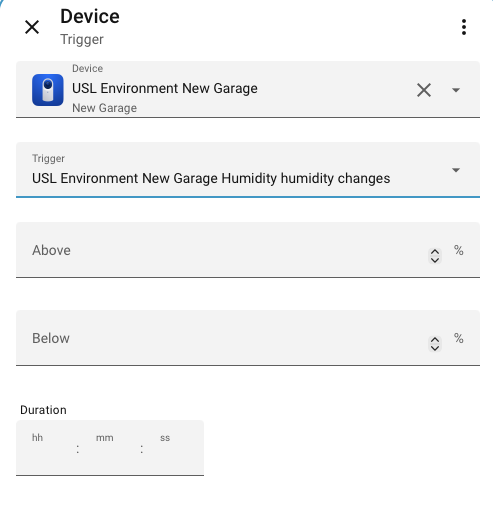

Thank you everybody I now have it working with 2 separate automations, However there are some conflicts between peoples advise to use numeric or state values. My issue is that as a 1st time user of HA which I was advised to buy because it had a built in integration for UNIFI and Indeed TAPO I got this:
Completing it intuitively ie above 60 and below 50 gives a result that does not work. Swapping the figures around does not work either. So in this case the system designed to help people who can't or don't want to edit in YAML does not work. I did not write the non working automation HA did it for me
