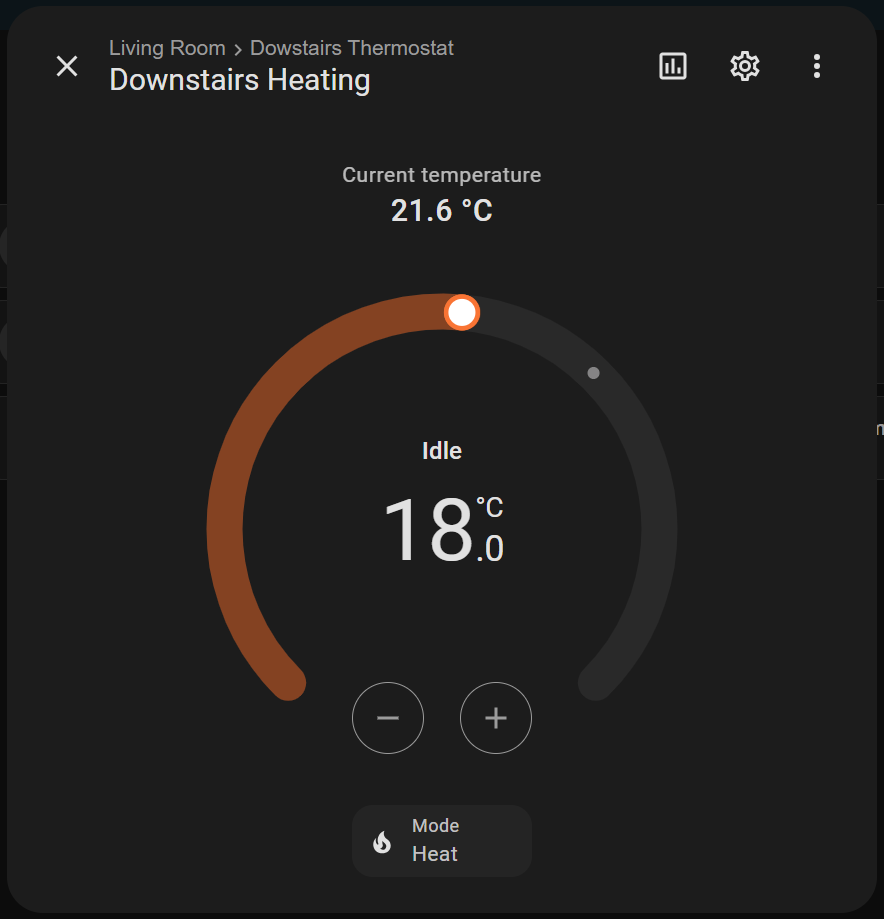

I have installed a second Bosch Room Thermostat II (BTH-RM230Z) to our house for our downstairs heating.
The device is integrated into HA and the device info page shows all the expected data, including the humidity value as a sensor.

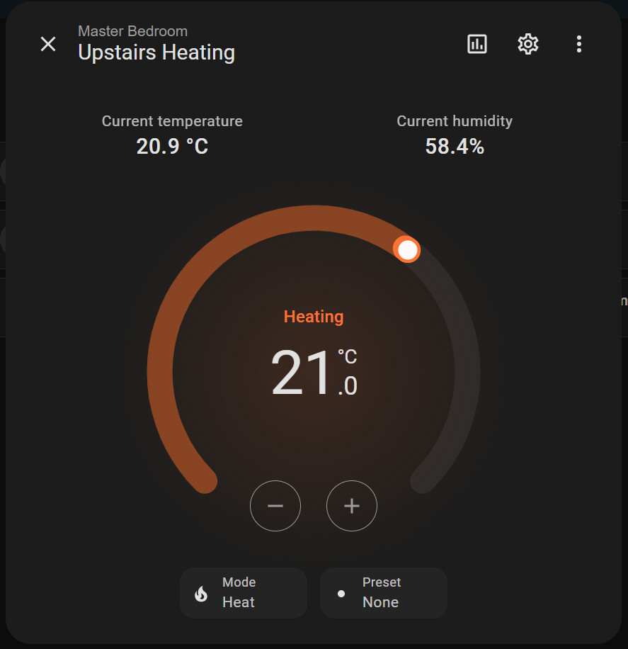

However, when adding the deivce to a dashboard the humidity value fails to show in the More Info modal. I expected it to show up beside the current temperature sensed by the thermostat.

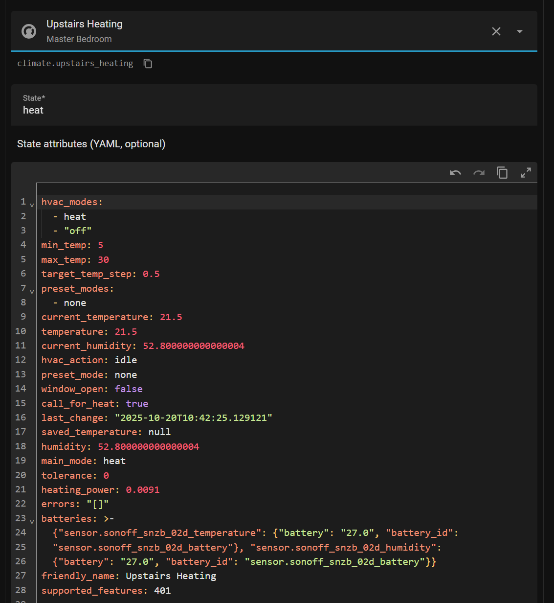

I have another same thermostat and a separate humidity sensor device upstairs integrated several months ago but via the Better Thermostat integration, and the humidity from that shows up in the card there OK:
So my guess is that the Better Thermostat integration exposes the humidity information in some different way to the direct integration, but I dont understand how or what to do about it.

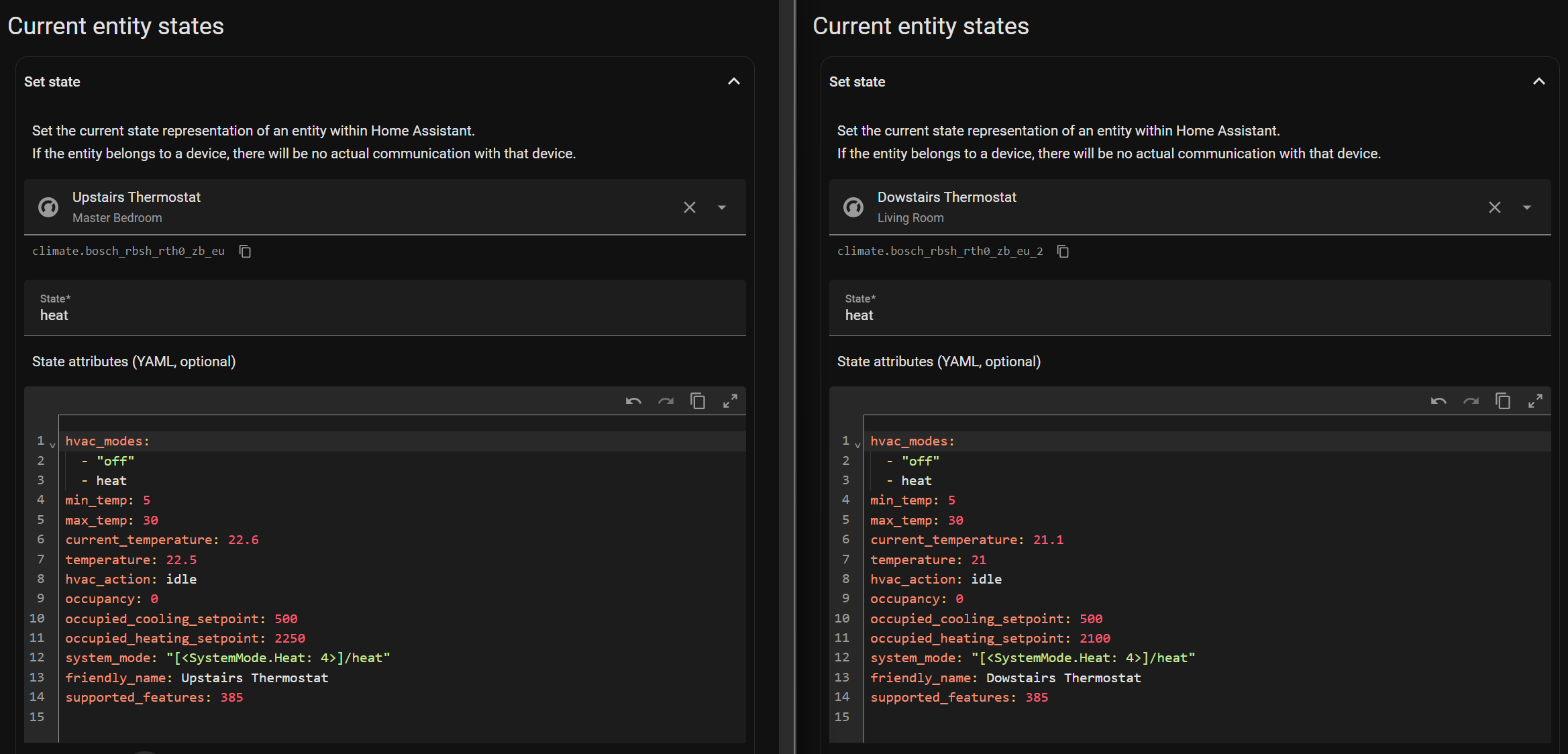

Can you compare the attributes of both climate entities from developer-tools/states?
Here are the two thermostats in the place that you indicated. Is this what you meant?

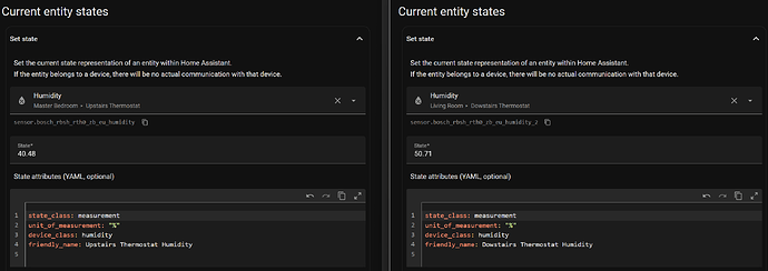

EDIT:
I realised I can do the same for the humidity sensor in each thermostat also:

So the more-info dialog for a climate entity will only use information from that entity, it won’t look at other entities of a device.
Im then I’m not sure why this shows humidity for one of thermostats, but not the other?
So far you’ve shown me one climate entity that has a current_humidity attribute.
Does the other entity have a current_humidity attribute?
Ah I see, one tile is refering to the thermostat but the other tile is refering to the BetterThermostat integration.
Thanks for helping me see the obvious! :smiley:
I’m not sure why the humidity would be exposed as a separate entity to the thermostat that it is physically part of but that it is up to the device (and pehaps the quirk?) I guess, not HA.
