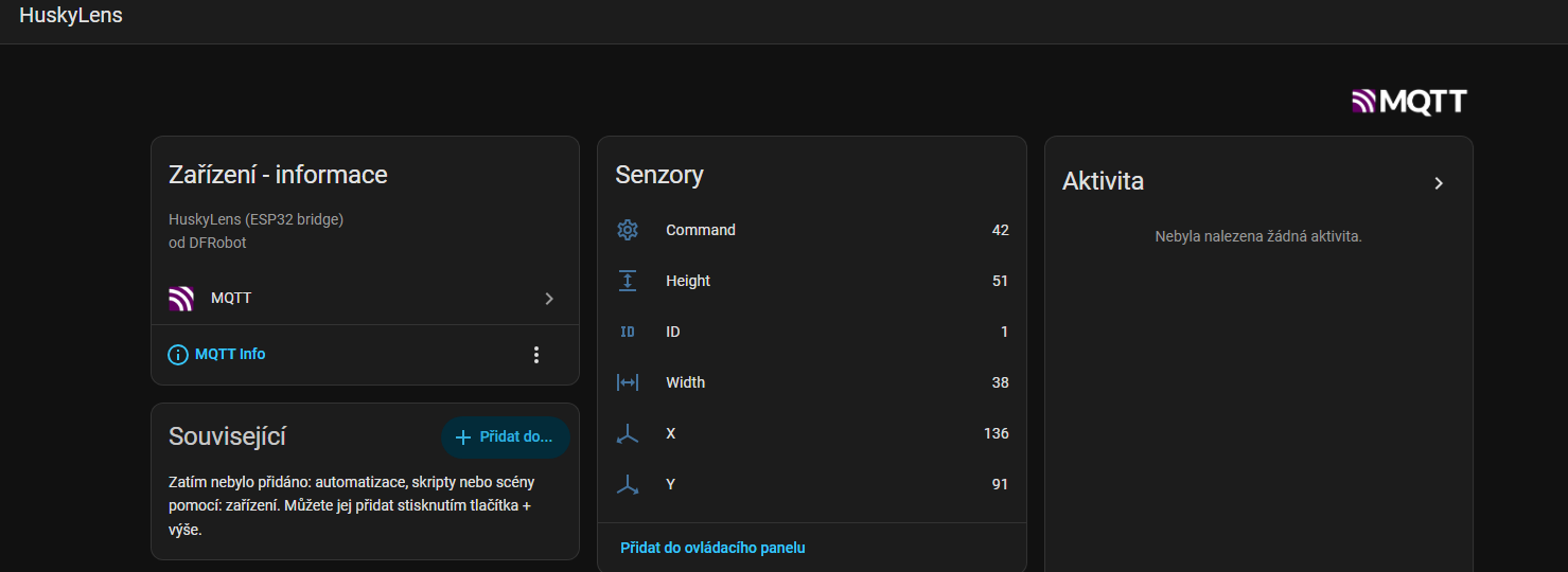

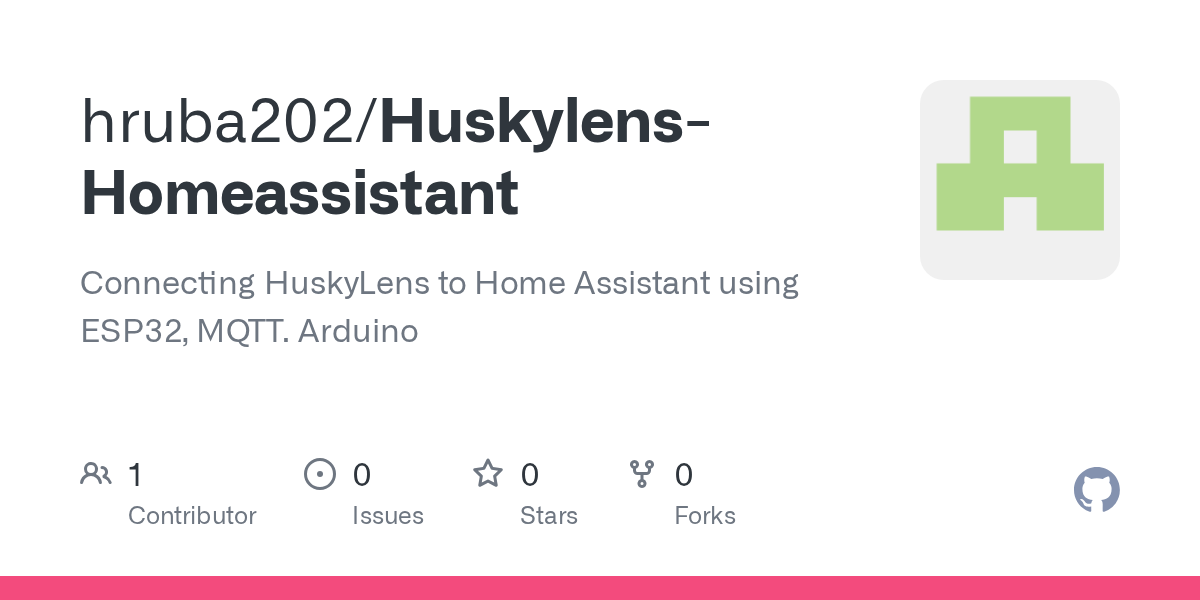

I wanted to use HuskyLens with Home Assistant—specifically for face recognition—and since there is no official integration,opted for what is likely the easiest solution: connecting via MQTT. The HuskyLens sends data to an ESP32 via I2C, and the ESP32 then forwards it via MQTT. I used the HuskyLens Arduino library as a starting point.
Tried this out - just to play with it. Works great. Thanks… still not sure what to do with it… but it works reliably!
