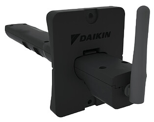

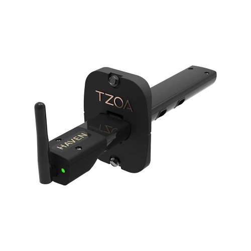

I’ve found some examples are below, but are proprietary and very expensive:
