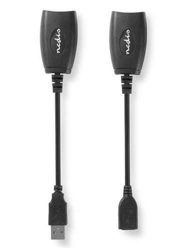

The USB standard max length for cables are 5m and even that can be problematic at times with certain devices.
Get a network coordinator instead.
Rated for 50m, cat5E / Cat6 Ethernet cable.
