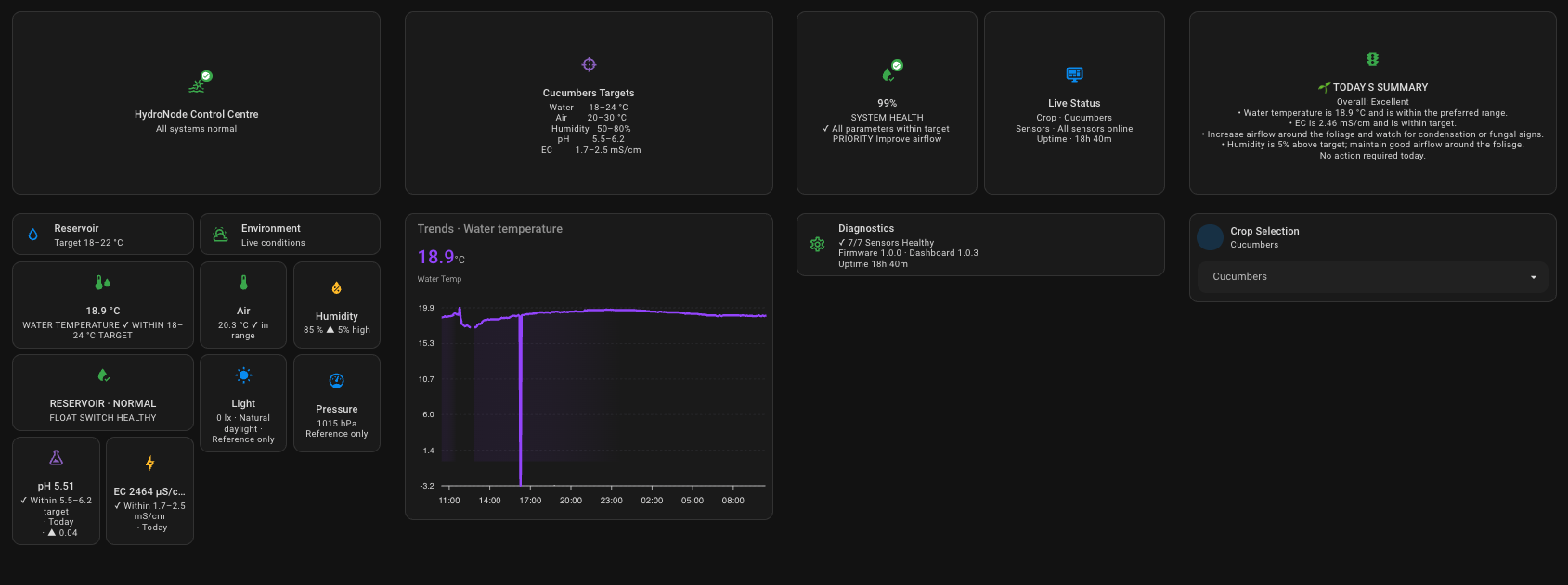

I got into Hydroponics through 3D printing as something to do and it’s spiralled a little bit…
I grow tomatoes, cucumbers, peppers and strawberries in DWC buckets. They are all a little different in their requirements.
I’ve spent the weekend (trying to) build an ESP Hydro controller to try and solve some of these issues. Slightly different than your project in that this looks after system health.
One thing that come up constantly for me, is trying to remember all of the pH/EC/PPM/temperature information for each of my systems.
With some help from an AI overlord, I did manage to create a journal on HA to try and manage some of this info and tell me what needs to happen with each system when parameters change.
Might be worth considering if you ever expand this?
