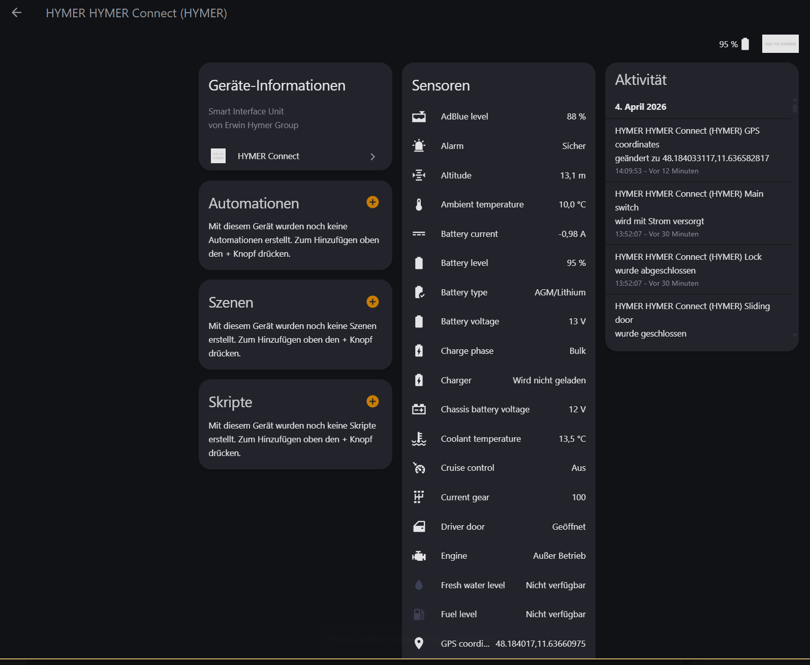

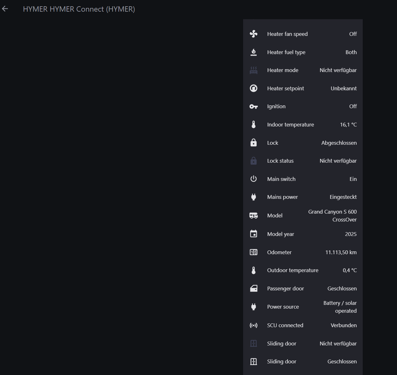

Device tracker GPS position on the HA map
Screenshots

Hello, first of all, thank you very much for your work. I regularly check to see if an integration is available.
However, I got stuck trying to find the tokens. In the end, I couldn’t install the APK. It would be great if there were an easier way to retrieve the information.
