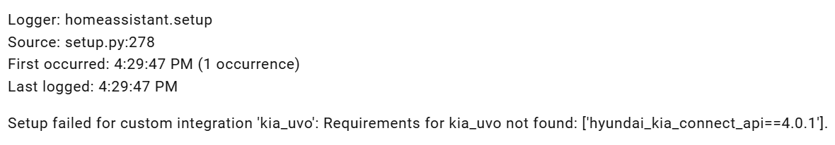

What do the logs show?
Logger: homeassistant.setup
Source: setup.py:278
First occurred: 4:29:47 PM (1 occurrence)
Last logged: 4:29:47 PM
Setup failed for custom integration 'kia_uvo': Requirements for kia_uvo not found: ['hyundai_kia_connect_api==4.0.1'].

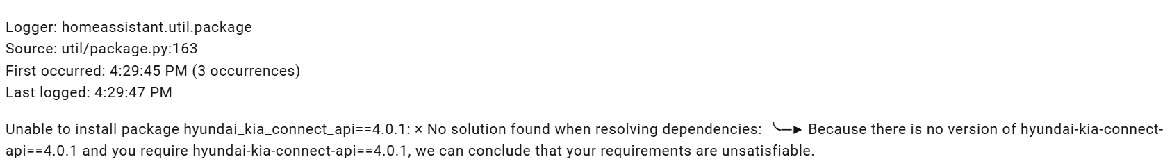

Logger: homeassistant.util.package
Source: util/package.py:163
First occurred: 4:29:45 PM (3 occurrences)
Unable to install package hyundai_kia_connect_api==4.0.1: × No solution found when resolving dependencies: ╰─▶ Because there is no version of hyundai-kia-connect-api==4.0.1 and you require hyundai-kia-connect-api==4.0.1, we can conclude that your requirements are unsatisfiable.

This is the root of the error, the integration has a newer version, and relies on a dependancy it cannot install.
It looks like the issue is fixed so you should be good to update again. Todays Update breaks working · Issue #1478 · Hyundai-Kia-Connect/kia_uvo · GitHub
Thanks. My HA does not offer (yet) a new version of the Hyundai Integration, but this does not matter. For the time being, by reloading the previous version, it works and I patiently wait for a new version.
