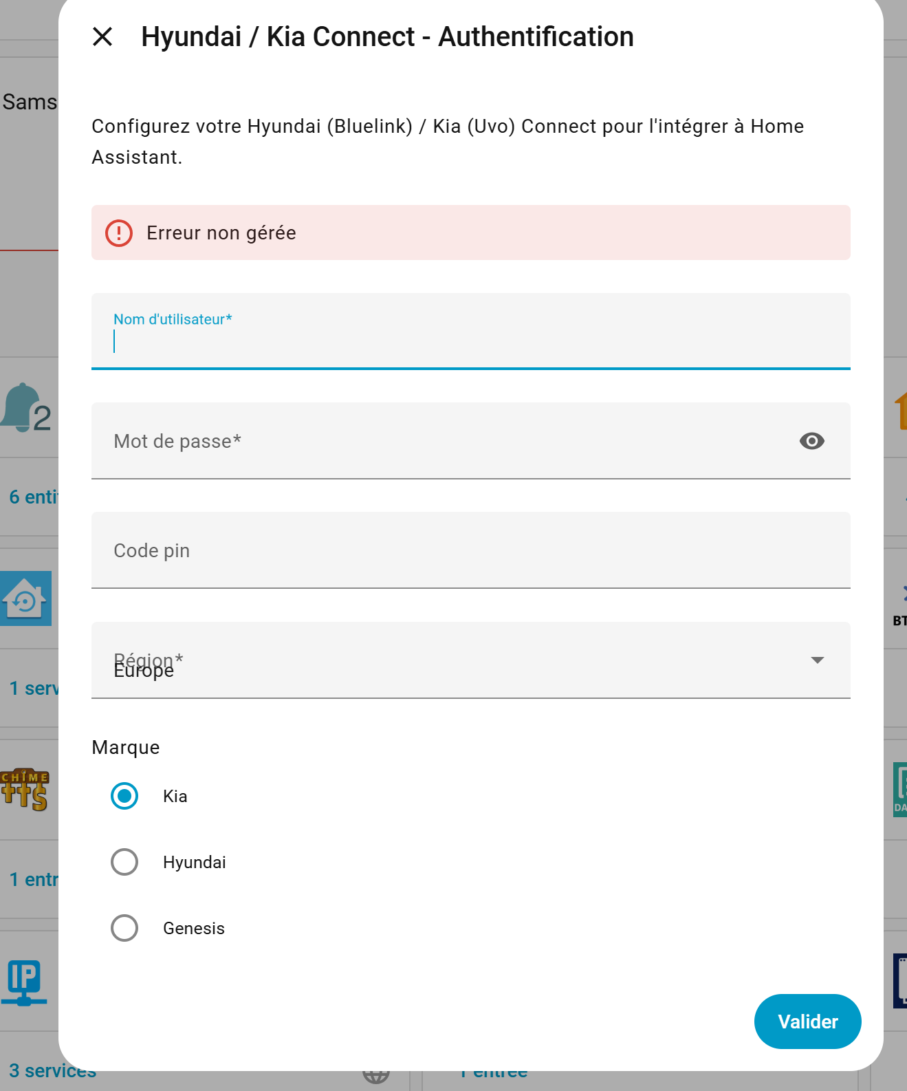

I was quite surprised to discover that the KIA integration no longer works, even though everything was fine and I had successfully completed the integration before. It’s true that I ignored previous updates for fear of having to reconfigure everything again. Attached is the screenshot I’m getting. What should I do? Thank you.
Unhandled error. I had previously entered my Gmail address, password, and PIN.

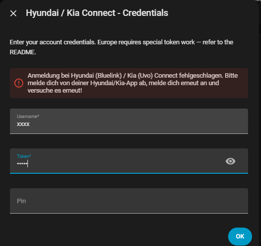

I too have been logged out by HA yesterday. I am Europe and have my token but it won’t let me back in. I don’t remember having to enter a PIN. Hoping it will self correct soon.

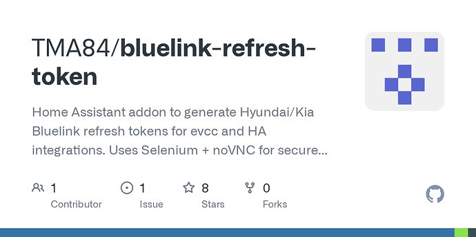

I used this App/Addon to solve the problem and it works pretty slick:
No script, Captcha or Chrome login needed.
After installing and starting the App in HA, you just fill in the username and password for your Hyundai Account on the Web UI and it will generate a Token - copy/paste - done!

However, I still can NOT configure it with the token from the logs and it's not recovering itself - even after a restart of HA.

After my discussion with KIA Sweden I almost gave up on getting info from my Kia Niro to Home Assistant. Then I read Frank Beetz post above regarding TMA84/Bluelink Token Generator. Installed the add-on and could immediately obtain the token I require. This add-on is intended for Europe so no use for you but I am sure a lot of European users will appreciate the effort put into producing the add-on
