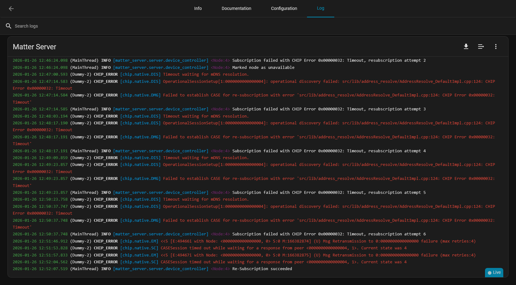

I am able to get the bulbs to connect via the companion app and work for a little while. They will have great performance, then at some random point in the next few hours they decide to break, not work consistently, and just be weird.
I get multiple mDNS timeouts and failure to establish CASE errors in the Matter server logs. I have enabled ipv6 on the network, RA is on high, Proxmox Multicast snooping is off, I have mDNS enabled on the network, no IGMP snooping or multicast-unicast controls. I cannot for the life of me figure out why it won’t work consistently. Please help, I just want to enjoy my cheap Matter devices, unless you guys thing I should just move to Zigbee.
