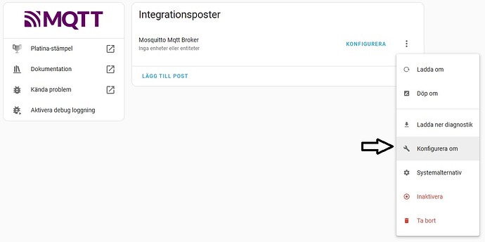

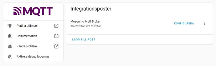

I have MQTT in Settings → Devices & Services but I can’t see any devices there. It says 1 POST there. When I click on it, I get to integration posts and there I don’t find any devices or services. See images.
Apparently I have to wait a few minutes before I can post the next picture. :slightly_smiling_face:
  1. Create an mqtt user as I explained above. Use that instead of your main user.
  2. You need to use the hub to add the devices. After you have done that and can see the topics in the broker…
  3. You will have to manually add mqtt entities in HA using YAML. See: Integrations - Home Assistant

Hi.
Now I have uninstalled MQTT and deleted the Integration and rebooted.
Then I installed MQTT and clicked on configure MQTT in Settings → Devices & Services and rebooted.
Everything is just like before, I can connect the hub with my admin login but not connect with the special MQTT login.
