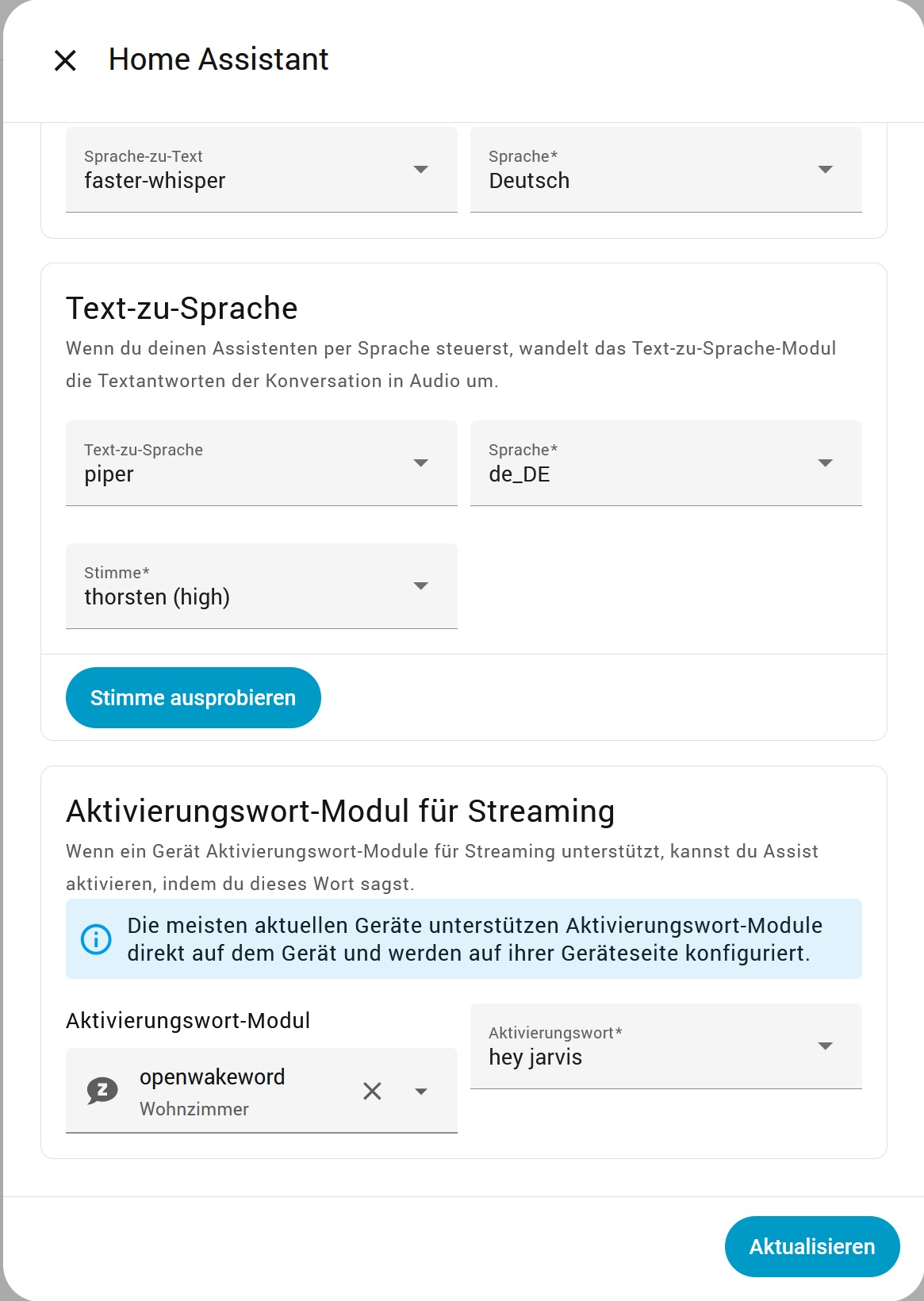

So, I’m at my wits’ end. I haven’t been able to get this wake word to work for days.
This is my next test step before I want to experiment with speech-to-phrase.
My first step was to test the microphone. I was able to stream it to my PC via UDP, so the microphone hardware and I2S connection are OK.
The next step was to test the speaker. Streaming internet radio to the “Marvin Media Player” works.
But the wake word won’t work!! (Although the name “Marvin” appears everywhere, everything was tested with the wake word “hey jarvis”.)
What am I doing wrong?

Try changing use wake word to true
I finally got it working. It was due to “bits_per_sample: 32bit” under “microphone:”. It has to be 32-bit for my INMP441 microphone; otherwise, the wake word doesn’t work at all; there’s no response at all. Since the sound on the PC speakers was relatively good with the 16-bit stream, I wouldn’t have expected this result. In any case, it’s not the quality that turns the wake word function on or off here, but rather the configuration value.
